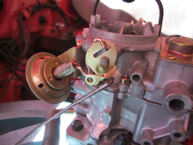

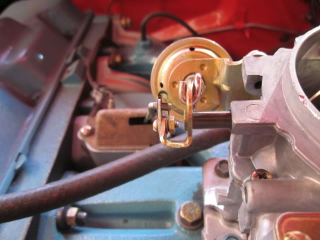

Sorry, I just saw this post. Here is my carb without the bracket:

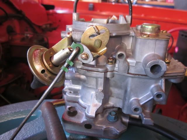

And with the bracket:
Without the bracket, the rod is below center-line of shaft, and tends to push it open, rather than closed.

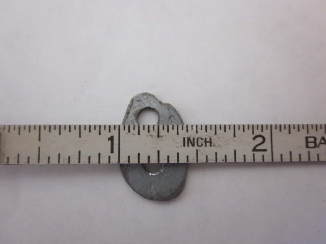

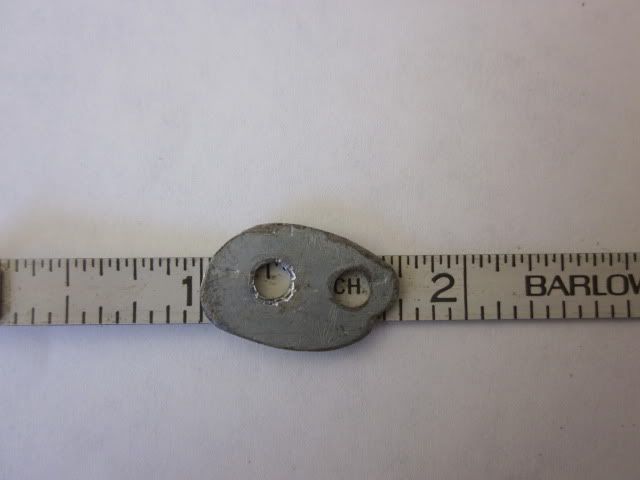

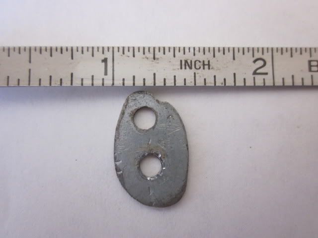

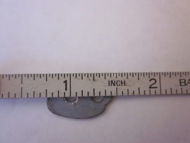

Pics of the bracket:
It's rather crude, but does the job. The idea is to keep it as small as possible, and try not to interfere with any part of the linkage. You just need to raise the choke linkage rod up so it's above the center-line of the choke shaft, so it will push the choke closed when it's cold.
