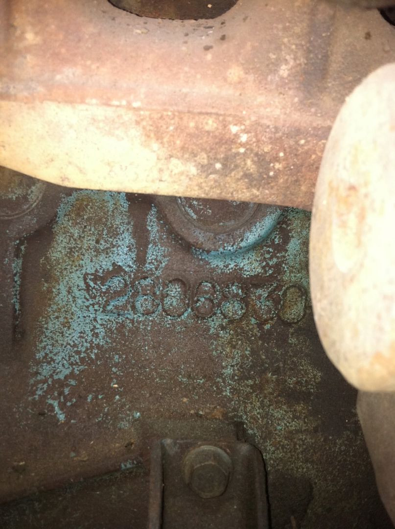

PostPosted: Thu Jun 16, 2011 4:01 pm
Posts: 13362
What is the casting number on the opposite side of the block?
It should be on the side of the engine block with the intake manifolds, directly above the motor mount boss.
It should look something like this:
PostPosted: Thu Jun 16, 2011 4:33 pm
Posts: 24927
H: 1972 model year
W: Windsor engine plant
225: Engine displacement
3729: October 13, 1971 engine build date
