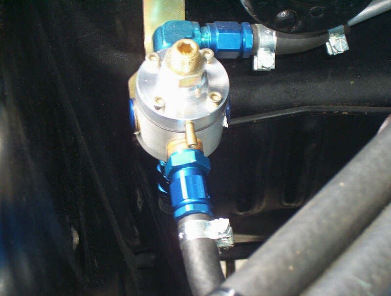

What fuel pressure or what kind of fuel system do you have? That fuel filter looks alittle dangerous next to the turbo housing. Just saying.

Hello Ryan, Now set @ 6psi, MSD EFI fuel pump, I am waiting on a 90* for the carb so I can move the fuel filter!
The Mallory #4309. 3-PORT COMPETITION FUEL PRESSURE regulator with VACUUM/BOOST COMPENSATION PORT (RETURN STYLE) Adjustment is from 3-12 PSI (approximate)

Also looks like a vacuum carb. Secondarys may not close when boost is on.....Normally a DP is used. be aware.

Also looks like a vacuum carb. Secondarys may not close ?when boost is on.....Normally a DP is used. be aware.
I think you were talking about the vacuum for the secondaires? The carb has, manual secondaries with no choke area at all. The fella that sold me that, said it should work fine for my application, what do you think Shaker? Thanks again for your knowledge.
Should work fine then. Just make sure your AFR is correct. Lean is the biggest killer of parts. Are you planning on using an O2 sensor?
