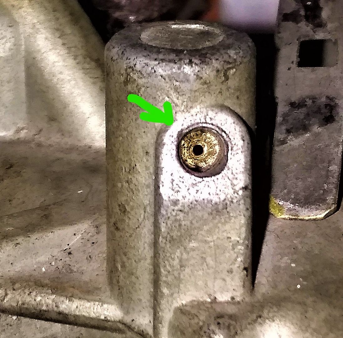

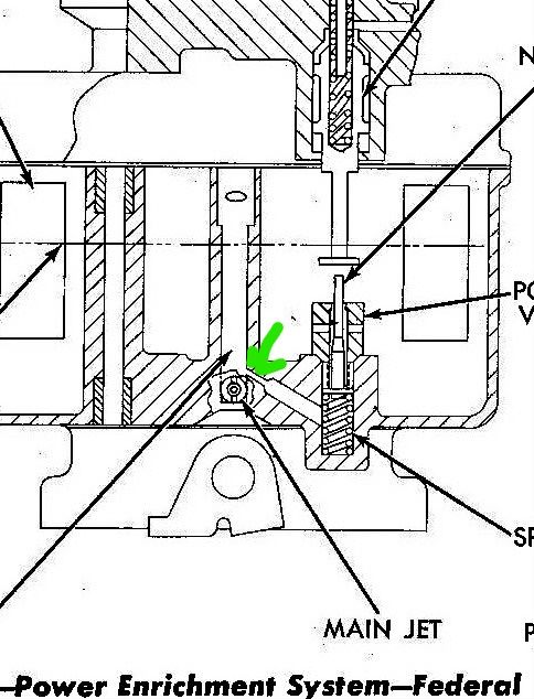

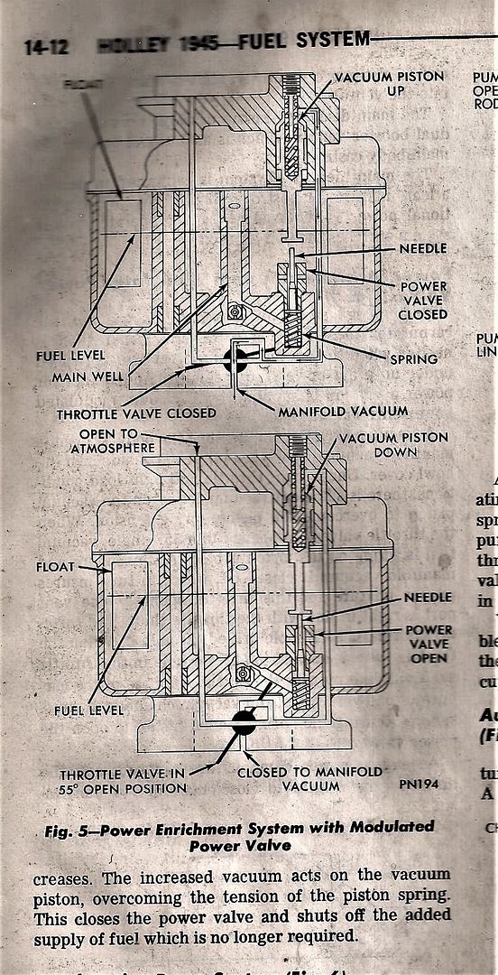

The green arrow points to restriction, small brass. Have measured two different carbs different sizes each carb one was about .033 the other one was point .051 |

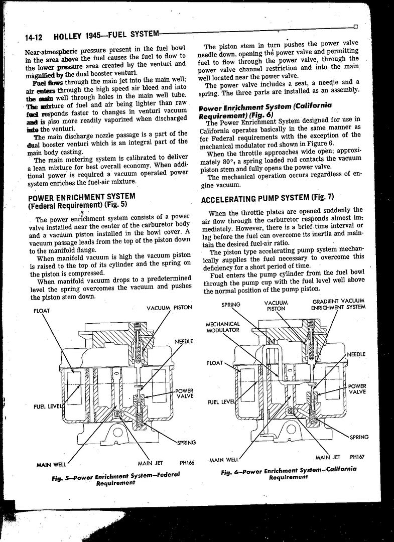

By 1976 both of those power valve systems previously posted we're gone replaced by a new system. Except for heavy duty emissions trucks which maintained the throttle modulated power valve. After a certain throttle opening was reached the vacuum supply to the power valve was dump to atmosphere. The California throttle modulator system apparently didn't work out either probably required real good throttle adjustment. |
