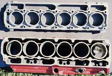

Anyone took a 3.5 inch hole saw to make a boring plate out of an old cyl. head?

I disagree with the premise of your question; I think it'd be a pretty interesting plate!

It is easier / faster to cut the top off a scrap engine block. Try to find one that is already bored oversize, then drill-out all the treaded head bolt holes, prior to sawing the deck off.
Or buy / rent a professionally made torque plate.
