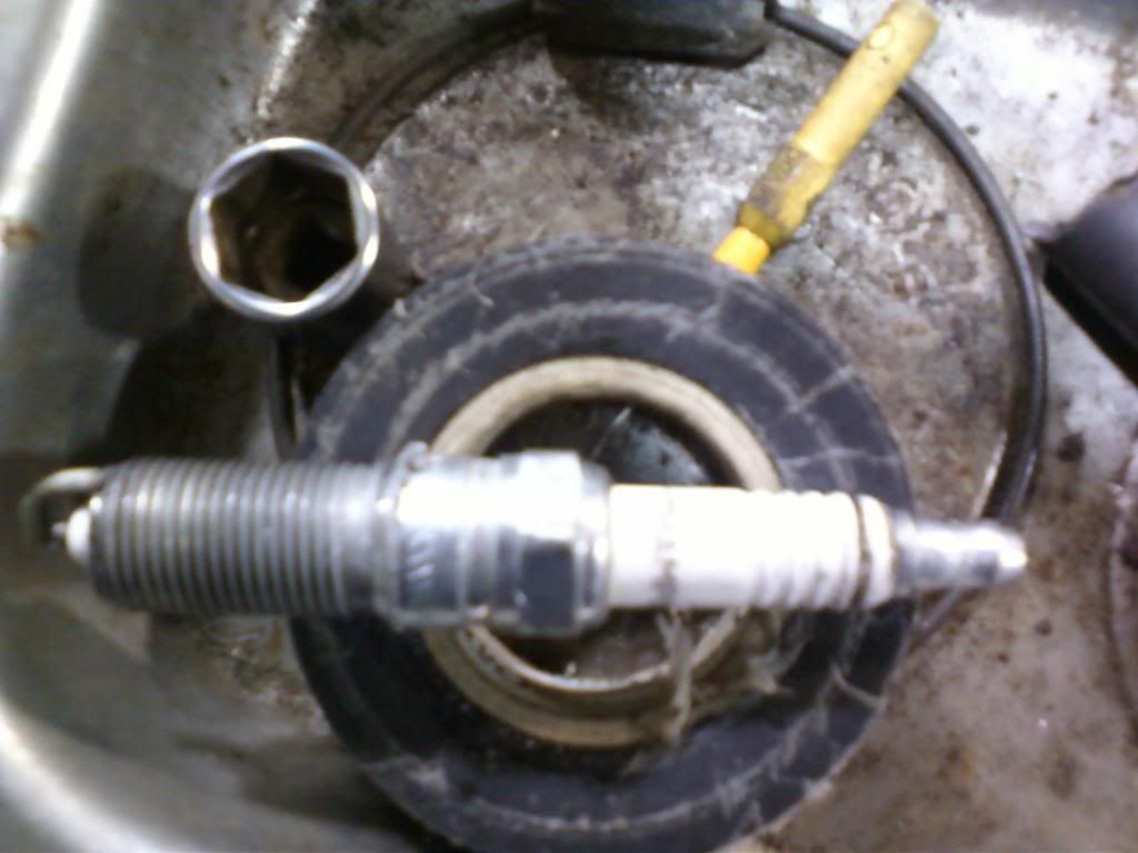

Today, at work, amidst the daily grind of fixing modern sh**boxes, I came upon this:
sorry for the blurry cell phone pic. they are tapered seat.
Champion number: RE16MC
Application: 2004 Chrysler PT Cruiser, 2.4L Turbo.
I was wondering if someone who knows more about plug numbers and heat ranges than me could tell if these are a viable option for an extended reach plug for peanut plug heads.
Maybe I'm just dreaming, thought it might be of some help.
Kevin :shrug:

Looks like it would make a good piston stop!
On NGK heat ranges a UR4 is colder than a UR6. UR6 is the stock plug for peanut plug heads.

OK, so I am just nuts :D I thought I remembered u guys with early heads running jeep 4.0 plugs and if memory serves me right, those are a very long plug like these with a gasket seat. Oh well, it was worth a shot.

PostPosted: Wed Oct 26, 2011 2:58 pm
Posts: 25055
Yup, it's wayyyy too long
No. Other way round. In NGK numbers, higher number = colder plug, lower number = hotter plug.
UR4 or UR5 depending on year. With today's clean-burning fuel, UR4 is unnecessarily hot, UR5 is a sound choice, and UR6 will buy some ping-resistance on an engine in good condition.

What is the maximum reach that would work, or more importantly, be of any benefit in a peanut plug head? I was on the Champion website, and the stock plugs are 5/8" reach, the ones i showed the pic of are 1" reach. Just curious so I can keep my eyes out for something that might work.

The stock plugs for 'peanut' heads has a 0.460" reach, the Champion catalog's 5/8" (0.625") must be incorrect.

Posts: 25055
You must use a plug of the correct reach. Longer or shorter is not okeh. "Reach" refers only to the length of threads as measured starting at the seat plane -- it does not include the length of the electrodes.
There's some variance on reach spec depending on source. In 1981, Chrysler said the reach on the Champion RBL16YC taper-seat spark plug for the 225 engine is 3/8" (0.375"). That plug appears to still be available in the U.K. product lineup (see here, showing in stock) with a stated reach of 0.42". In the US lineup, that plug has been replaced by the RV15YC4, which has a stated reach of 0.46". NGK say the plug for this application (UR4) has a reach of 0.625".
Which spec is right? Maybe all of them; remember we're dealing with a tapered seating plane, so there is probably some variation in where the reach is measured from.
(also take note the plugs above -- Champion 16s and NGK 4s -- are at least one heat range hotter than is probably optimal with today's fuels)
Not correct. If you have been on ngk.com site, you will see in the side bar on the left side that the text layout is so bad, that it is very easy to read the 5/8" as Reach, when in fact it is the number on the line above that describes the reach.
I have both UR4 and UR45IX plugs here, they both have a .460 reach.

Posts: 25055
Good catch; I misread the NGK presentation on that plug on that site.
