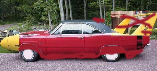

Posts: 13276
Actually, the front of that car is pretty much what I was talking about. Add wings/spoilers or air tabs to the back of the roof right over the rear window and the back of the trunk to reduce the drag in those areas and you will get some improvements. Belly pans, air dams, fender skirts, etc.. add little gains, but they add up.
I would lose the big rear wing and add a tiny airfoil on the back of the roof and the back of the trunk, or air tabs. Aluminum wheel covers, fender skirts front and back, side ground effects to block air flow under the body, belly pan, rear bumper cover, and you might get a noticeable difference. Plus, I think it kind of looks cool.
Sorry for the lousy Photoshop skills.
I think when I get my brother's Duster on the road (2012 maybe) we will play around with some of these ideas.
