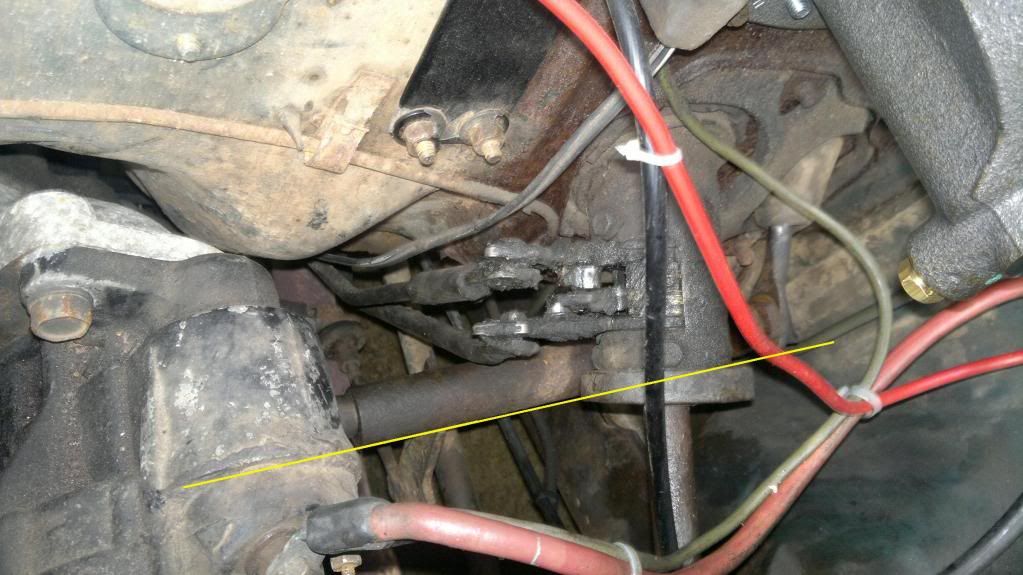

Was poking around my 65 dart today, and discovered that my z-bar is a bit crooked and one side sticks farther foward than it should. ( clutch motion has felt off since purchasing the car a month ago or so)
upon further inspection seems that the bracket that holds the linkage to the bell housing isn't on correctly. using 2 bolts instead of the supposed 3 causing the bracket to twist up and out (forward) pushing the z-bar up and out (no wonder it fells weird.... still works though)
without a supply of spare bolts kicking around i decided to take out the remaining bolts and try to install them on the lowest and highest bolt holes to see if that would cut down on twisting etc.
but seems that the shift linkage interferes with where the z bar should be to be level and have the brakcet lined up with the holes on the bell housing. not sure where to start on this one. any ideas?

PostPosted: Fri Nov 11, 2011 2:17 pm
Joined: Mon Aug 22, 2011 10:14 pm
Posts: 81
Location: Abbotsford, BC CANADA
i've circled the ones that look closest to whats on my car
in the first photo here the red arrows point to two holes that i believe ought to be lined up, bringing the zbar closer to straight again.
the yellow arrow is point to a third hole on the braket (obstucted view in this photo) but looks like it had been added on later with a shoddy weld job.
third photo to show how crooked the bar is, and that there is NO clearance between the shift linkage for the bar to go back any
any thoughts?
Franklyn
1965 Dart GT - 1949 Plymouth Special Deluxe
