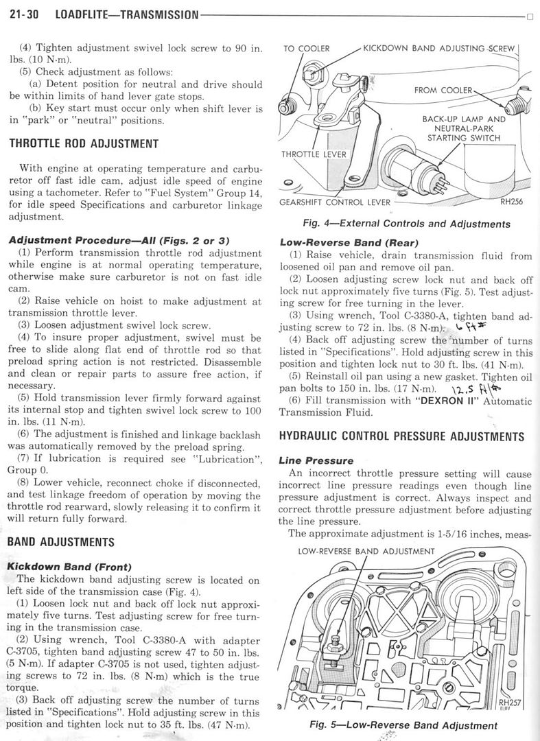

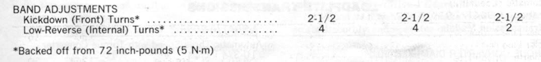

Adjusting the bands is actually very easy. Here are the directions from my 1984 Dodge van factory service manual:
Don't have a torque wrench that tells you 72 inch pounds or 5 foot pounds? Try making the bolts finger tight and backing off from there.
