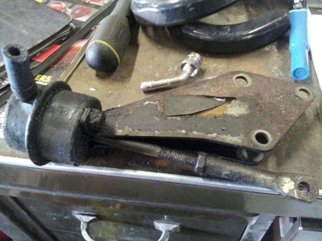

I'm not sure what your factory wastegate actuator looks like but most look relitivly close to this.
The way it works is boost pressure is applyed from the Turbo cold side outlet to the top of the diaphragm which moves the rod and opens the wastegate door inside the exhaust housing. By what you said it takes around 9-10 Psi to overcome the spring and open your wastegate completely. The way the cheap boost controllers work is by adding a controlled amount of boost pressure to the opposite side of the diaphragm. So if you add 1 psi to the spring side of the diaphragm your boost pressure should increase by 1 psi.
Now if you adjusted the rod length to be longer the wastegate should start opening sooner and be completely open soon lowering Max boost pressure. So give it a try, but you might find that the internal wastegate can't flow high enuff and cause boost creep at higher rpm. Hope this helps, Cory

I went and looked at the waste gate. It looks like the rod extends from the actuator to open the wastegate. Since I put a turnbuckle in the rod to lengthen, or shorten it, I could put a compression coil spring between the actuator and the turnbuckle to apply opening pressure. I would have to buy different strengths and lengths and try them to see what worked. I have no idea how much pressure the actuator pot applies to open the waste gate. Thanks for giving me some direction here. I will let you know what happens.

Done! But, I could not test drive it because it is raining AGAIN. So, I have no idea if this is not strong enough, or too strong. I was annoyed that Home Depot drove the real hardware store around here out of business, and they sell springs only in packs of 3 or 4 each. Now I have extras that may or may not ever be used for anything.
Does anybody know what the 2nd hose to the actuator does. It is vacuum on one side. But it seems thatboth sides would see boost and cancel each other out. :?
Sam

There is vacuum on the side of the pot towards the wastegate, and boost reference signal on the side away from the waste gate. It seems there must be some kind of check valve on the vacuum side,as it would become boost at the same rate as the rest of the induction system, would it not?
