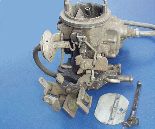

stock slant, 1bb carter, with rod application. too sloppy. 63 plymouth signet valiant, pushbutton 3 speed.
PostPosted: Wed Apr 04, 2012 3:47 pm
Posts: 4880
It sounds like you have all the parts but need to replace the "bushings & insulator" pieces to get the positive action back.
Usually the Insulator, at the carb is the reason for loosness in this linkage system. (14-11-30)

I actually need the shaft. and Insulator. Dan will Gary have these ?
PostPosted: Fri Apr 06, 2012 9:26 am
Posts: 24950
Insulator yes, shaft no. The shaft usually doesn't break or fail, what happened to yours?

Different rod from accelerator pedal to bell crank and from bell crank to carb for 170 vs. 225 engines.
