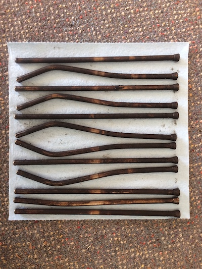

Over the next few years the D100 was my daily driver.During this time I got to experience many adventures of driving and repairing a vintage Dodge pickup. :lol:
My son also used it as his daily driver until Jan 2013 when he got a new ride and the Dodge got parked. It sat idle for almost four years. during that time my wife and I moved about 80 miles away which added to the inattention.
Finally, January 2017 I jumped back in and got it running. this is when the bad gas lesson was learned.
We got this fixed with new push rods, a clean gas tank and a rebuilt carb.

Yikes! That's a lot of bent push rods! Nice looking truck though. I have an '84 D100 and had an '86 W150, and an '83 van, all slant powered. Plenty of power on flat land or down hill.
