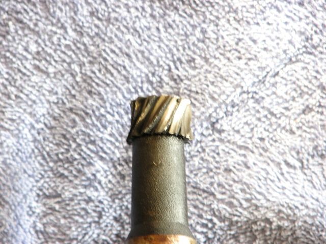

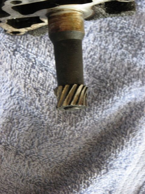

Here is the original 130,000 mile gear failure

In the pic it looks to me as if the oil pump gear is pressed on too far onto the shaft. Maybe?? What clearance do you have between the body and the gear?
The original 100,000 plus gear that looks like it is pressed on to far is tight against the body. I cant even get a .002 feeler gauge between the gear and the body.
The other pump has .018 between the gear and the body. I also found out this evening that this engine had maybe 15000 miles on it.
Can someone tell what the clearance should be between the pump gear and the body? I have a new pump and one of Doc's hardened gears that I will be pressing on soon.
Thanks , Rick
PostPosted: Mon Sep 10, 2012 4:35 pm
Posts: 4880
I shoot for .010 of clearance between the gear and the pump housing.
