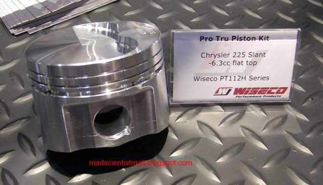

With the Silvolite 2.2 pistons, there is the 1290H, 1291H & 1292, the first 2 ("H") are hypereutectic material and the 1292 is not. None of these have steel expansion control struts.
The factory 2.2 pistons have the steel struts but unknown material alloy.
The KB239 & 268 are also Hyper with no struts but use a special heat treatment for added hardness.
The Wiseco units are forged pistons and there were also forged TRW and Sealed Power units, that are now discontinued but some still "pop-up" now and again.
For a "budget" street build, the KB units are a good choice but more $$ then the Silvolite units. The Wiseco forged pistons are also a great value.
