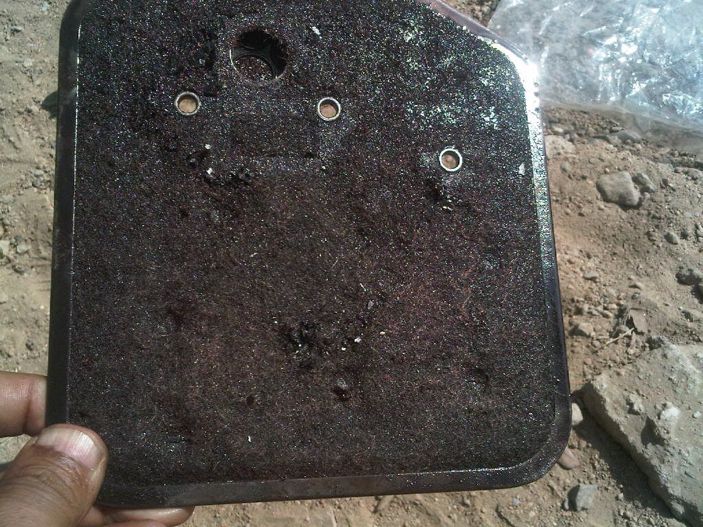

after looking the oil filter condition i have decided to pull the Trany out of the car. i know i will not get any single part in Karachi but i will try to do swaping some parts from different new model tranys.
this is oil filter

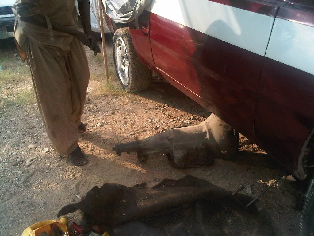

Trany coming out of my Duster

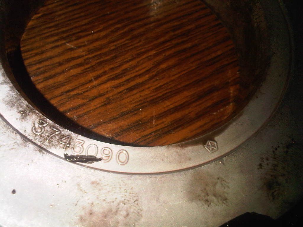

I did not found 904 on bodey instade i found this
this is the cooler bypass which probably cause trans burn out???
I will fix some local cooler made by Hyundai pickup truck.
and at last this is the hero alone took the trans out from my car with out any special jacks or tool.....

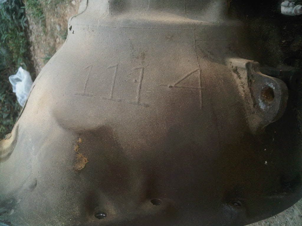

by the way is this my trans is 904 ? because i found 111-4 number on bell mouth (u can see in pics)
Thanks for help in advance. :wink:
PostPosted: Sun Oct 21, 2012 2:47 pm
Posts: 13280
Yes, your transmission is a 904.

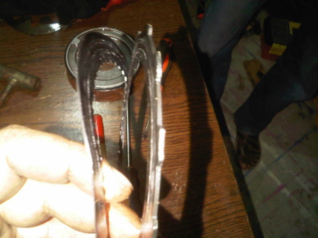

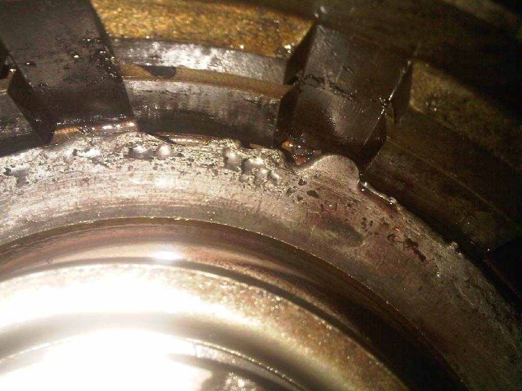

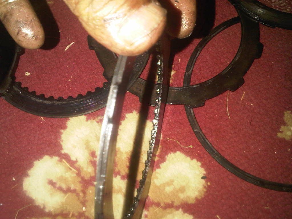

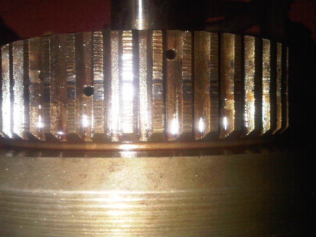

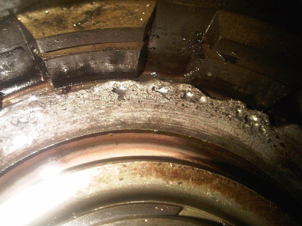

Hi Friends,

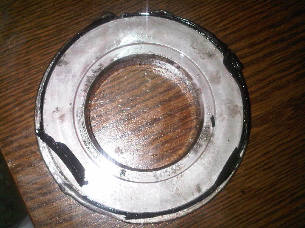

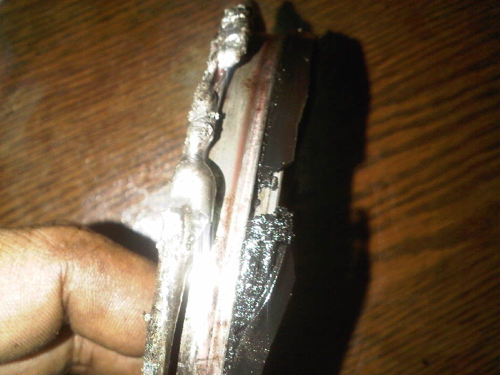

I have open up the transmission and found Direct Clutch plates are welded to gather to intance heat and the silver piston is melted see the pic below. now good news is that my Aunti is agree to bring parts for me from USA. She is living in Cicago IL. now the plan is that as per suggested by Ceej and Reeds i will buy the A904 Transmission Deluxe Rebuild Kit TF-6 TF6 but i am unable to find the silver Piston bottom of the clutches hold by gient spring see the snap. kindly help me so i can forward the links to my Aunti so she can buy from eBay. Thanks
piston pic
PostPosted: Sun Nov 11, 2012 10:12 am
6 Pack Dart
Posts: 2281
Location: Eugene, Oregon
Part is called piston, you might be best to get the whole assembly.
