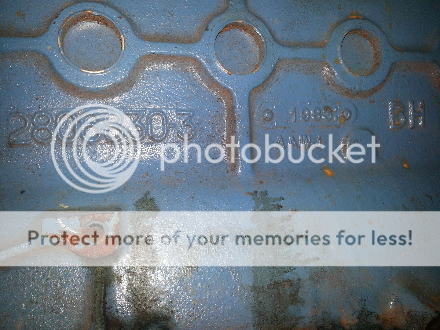

I am getting ready to build out my engine and I need some help. I was told that it was a 1983 engine but from what I can find online it appears to be a 68-74 slant six.
Can anyone help me?
Also since I am getting ready to build it out any suggestions on moderate performance upgrades? I have pulled everything and cleaned it.

Welcome to the board jhdeval. Is the car you are working on a ’65 Cuda? Don’t be shy, tell us about your car.
That block looks to be 1968-70 casting. Perhaps it was rebuilt in ‘83 and someone got the story turned around to be a 1983 engine. This [url=http://www.mymopar.com/index.php?pid=66]page[/url] will help identifying other parts on you car.

It is a 65 barracuda with a slant in it. The block has a crack in the water jacket to the outside on the engine. I am replacing it with the block in the picture.
I use it as a daily driver but I want something with a bit more oompf and I know the slant can do it. I would like aomething that I wont be afraid to pop off the line.

Don't junk the old block it can be saved by drilling and taping and inserting plugs using overlaping holes.

There is no problem using the block with the earlier engines parts. The crankshaft register on the '74 BH block is a different size, so the early crank should be used, or get an appropriate bushing to reduce the size of the register to allow the use of the early transmission.
Doc sometimes has those bushings, so contact him here.
