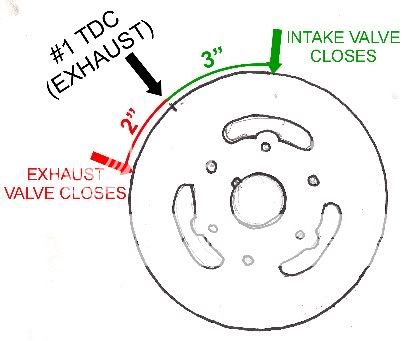

I made a graphic of my damper to show my results:
So it would seem that the cam and crank are not in time. My next question is, which way should I turn the cam to correct this? My initial thought was to turn it one tooth counter-clockwise because it seems the cam is advanced too much. WOULD THIS BE RIGHT?

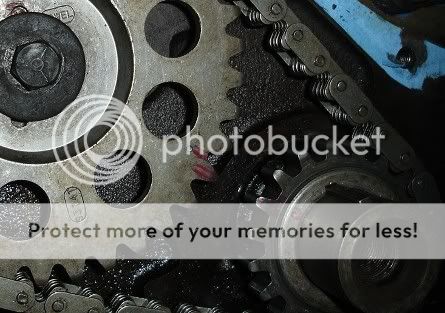

Here's a pic of the dots which seem to be almost lined up on the gears. The way the dots look makes it seem like the cam should turned clockwise one tooth, but I don't want to rely on the appearance of the dots. I looked at the old gears from this motor and the dots seem to be in the exact same place. So why do these gears put me in the wrong timing?
Any further advice or suggestions are appreciated. THANKS!!

Nice drawing but...
The intake valve will start to open before TDC Ex (overlap event) and the exhaust valve will close after TDCEx. ( Intake label should read "Intake Opens")
If this is true, you should be OK where you are... the intake is opening a little sooner then the exhaust is closing, this tells me that the cam is slightly advanced and that is what you want.
One note: Having 2" (inches?) and 3" (inches?) on either side of TDC is a lot... for stock cams, with the lash adjusted to spec, this is usually 15 to 20 degrees. (about 1 inch)
Re-adjust the valve lash... on the loose side and check again. Aslo look for other causes for the rough running, like a vacuum leak.

Doc, I'm so confused! The way I did your test was to line up the TDC mark on the damper and then check that both valves for cylinder #1 were open. By which I mean that both of the rockers were solid, couldn't be shaken, or moved. The rockers on #6 could both be jiggled freely. This would mean I am at TDC on the exhaust stroke, right?
When I rotated the damper counter-clockwise I shook the rocker arm of intake until it could be moved slightly. Made note of the position.
Then I rotated the damper clockwise, past TDC mark until the rocker arm freed up a little on the exhaust valve. Made note of the position.
And the graphic shows my results (I traced my damper after pulling it).
Providing I did the test correctly, are you really quite certain that I don't have a timing issue? To get the car to run, my distributor has had to be advanced one tooth past what I'm pretty certain it is supposed to be at. My intentions have always been to set this engine to "stock". We had hoped to set the car to run at 0 degrees TDC with the timing gun and then maybe advance it a hair if needed. Currently, the gun shows the timing mark (sometimes erratic) usually hovering way way in the BEFORE.
I've really been banking on the fact that I have a timing issue because everything else under the hood has been swapped over and everything was working great with the old engine.
One thing we've noticed is that to get the car running steady (the way it is currently with no valve cover on) we have to completely block the PCV valve. If we let go of the valve the car stalls and dies almost immediately. Is that normal? Everything else on the carb is either blocked off or connected.

Looking at your picture, the cam looks to be 1 tooth retarded.
