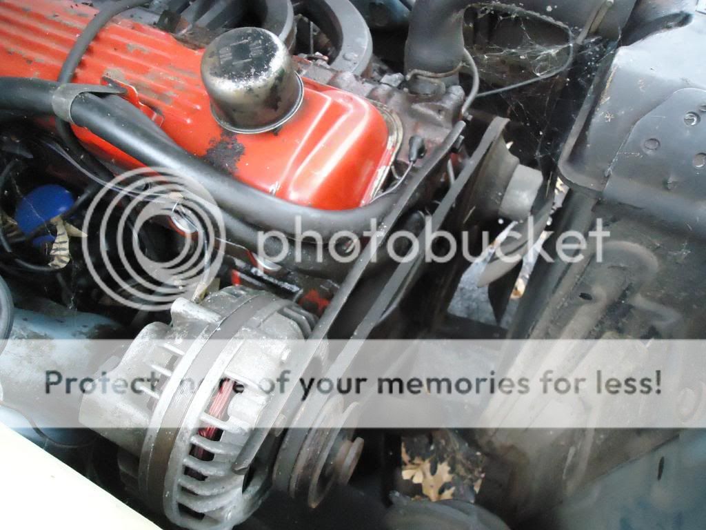

Here's the original single belt setup on mine (manual steering). Note the fan hub spacer is on the front of the pulley as mentioned above, this puts the pump pulley in proper alignment and spaces the fan out toward the radiator.
Please ignore the dual groove pulley on the alternator, it has nothing to do with a second belt or power steering etc, it is not the correct alt pulley for this application:
