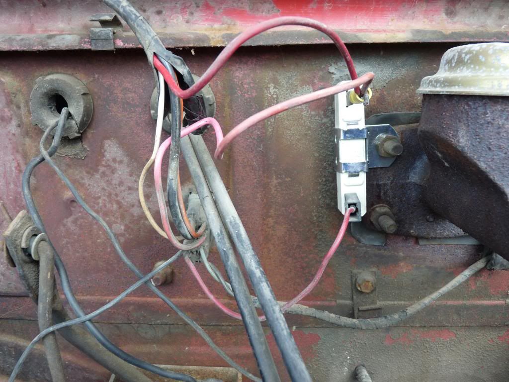

Another thing I did was recheck the wiring under the hood per the diagram in the manual i purchased. All wires are where they should be.

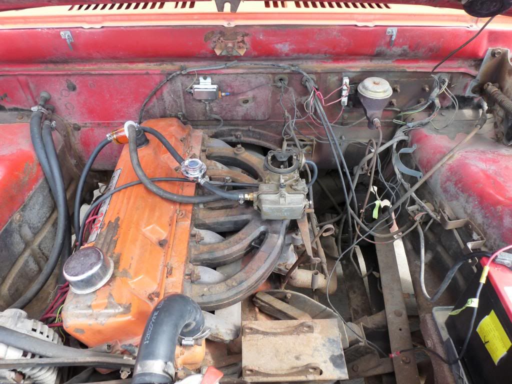

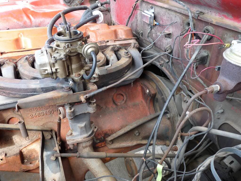

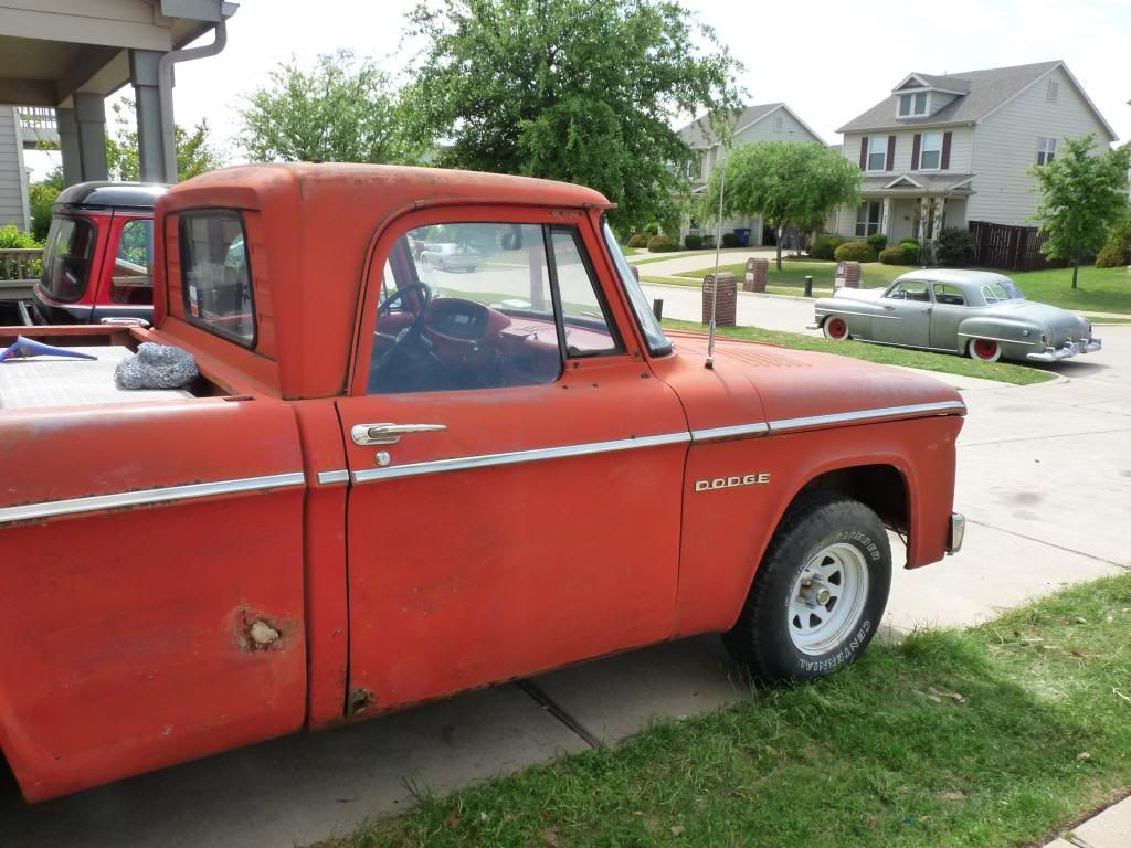

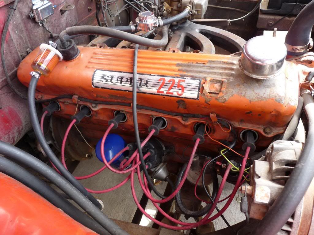

Few random pics.

Your choke isn't working right. Watch the linkage on the side of the carb in that video. The choke is closed when the motor is of, but as soon as you start the engine the choke flops open due to air flow. As soon as the motor dies due to no choke, the choke then flops closed again. I suspect you are either missing or have disconnected the choke thermostat rod that holds the choke closed when the motor is cold and slowly opens as the motor heats up. Either reconnect it or replace it. In the short run, try and start it with a fried or a piece of wire holding the choke mostly closed but with a 1/4 inch gap.
I looked at the pictures you posted and the choke thermostat is clearly missing. It bolts into that cup on the exhaust manifold and has a rod that attaches to the choke linkage.
Interesting. Looks like the truck had A/C.

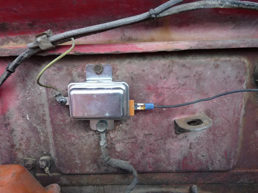

The choke situation is the most obvious cause of failure to run. Once that is dealt with (A manual choke setup from the generic auto parts store will do) I notice the silver colored new looking voltage regulator bolted to the kinda nasty looking firewall. The regulator needs to have a good solid case ground! unbolt it and sandpaper the firewall area where the bolts go through. Get rid of any rust or corrosion on the firewall and the back of the mounting ears on the regulator, so there's bright metal on both sides. Smear some grease on both sides (Vaseline works fine) to keep air and moisture away from your nice clean connection.
About your throttle linkage, I can't see what you have to work with from the carb to the firewall. That may take some creative fabrication. It looks like there was a carb with the throttle shaft running from side to side, like a V-8 engine. The Holley that's on the /6 now has the throttle shaft running fore and aft.
I see two rods running from the area of the carb that look like throttle and transmission pressure (kickdown) rods. Does the truck have an automatic tranny?? If so, you'll want to pull the lever on the left side of the transmission back and wire it in place. That will keep from damaging the tranny when you drive it.
