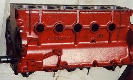

PostPosted: Fri May 17, 2013 2:19 pm
Posts: 4880
A 71 Challenger should have a "5 freeze plug" block with casting number 2806830-XX on the driver's side.
The gussit behind the water pump will taper, getting bigger at the block.
Basically, these are 68 thru 76 forged crank SL6 blocks.
As most know, all the auto manufacturers started stamping partial VIN numbers onto engines and transmission cases, in the late 1960s (1969 model year) so your engine & trans shauld carry part of the vehicle's VIN number.
For a SL6, that would be on the side of a casting boss, along the lifter gallery, (passenger side) near the rear of the engine block. You will need a mirror to see it when the engine is in the car.
