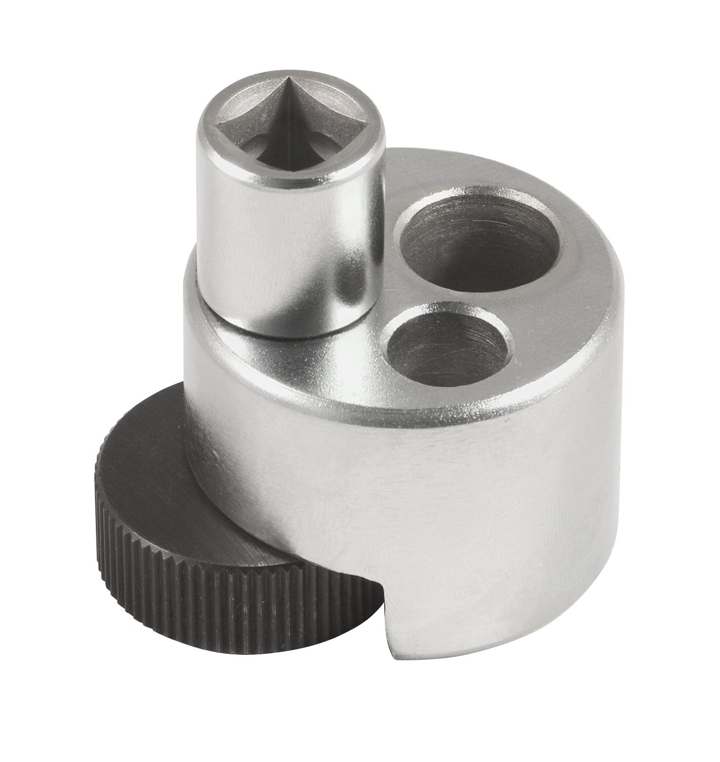

Not the cheapest way, by any stretch, but Snap-On's collet-type, CG-500 set does it best, IMHO:

I have found it seems to help giving each stud a firm tap on the end of the studs with a brass hammer. This is after an overnight soak with a rust penetrant.
I then use a stud remover as pictured above,but the studs are almost too small for the tool. Vice grips may be the way first.
