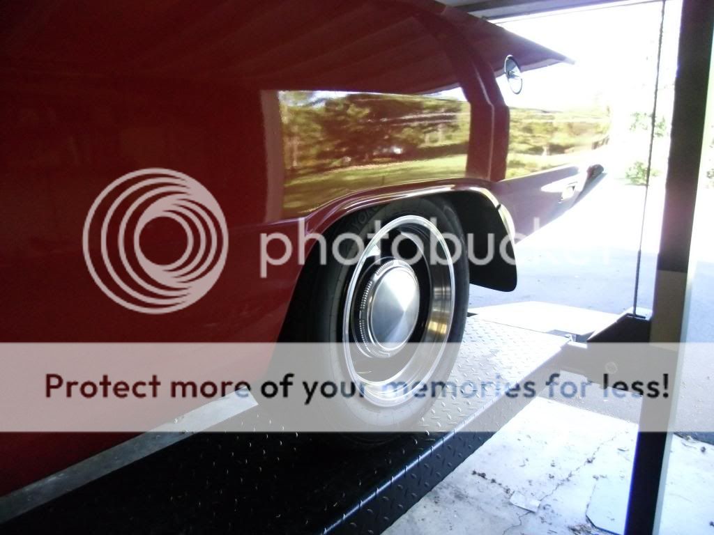

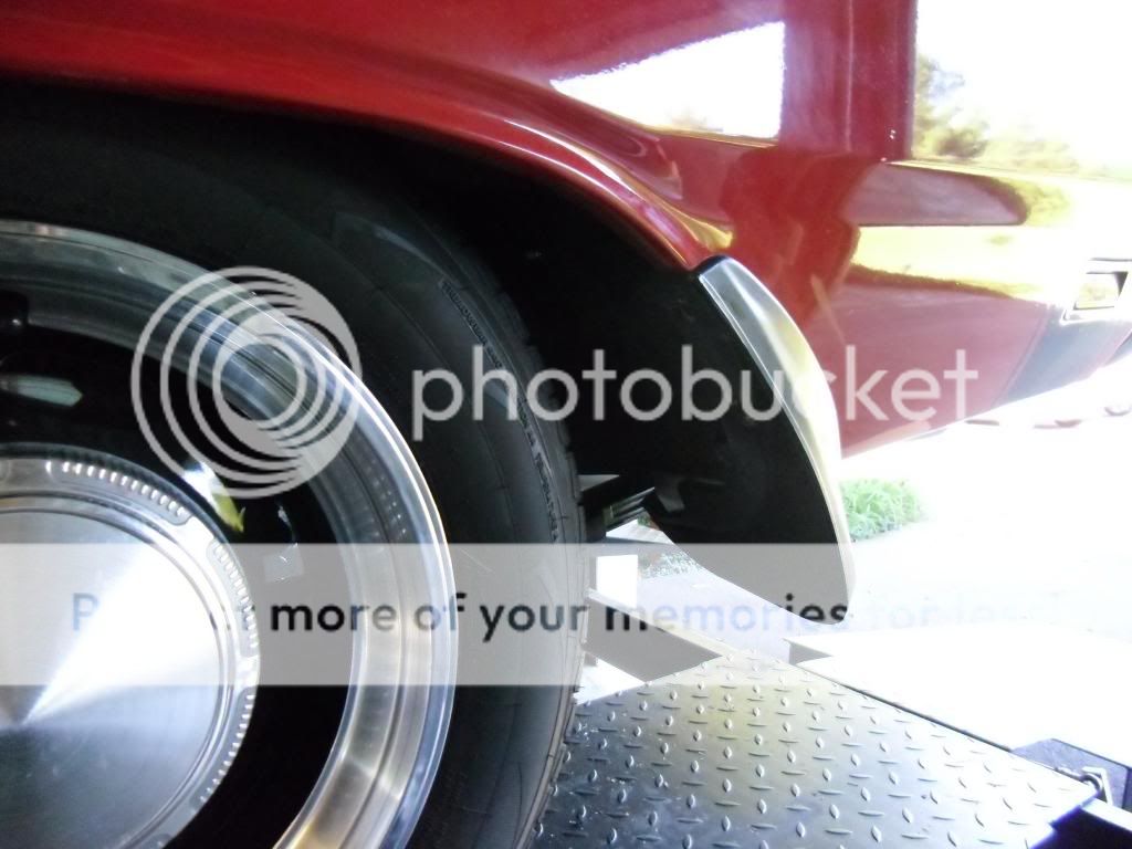

To fair in the undersides of the rear, one must also fill in the rear of the rear wheelwell, which are wide open on Mopars, mostly owing to the leaf springs, which do present a challenge. While at the junk yard last week I picked up the rear wheel well liners from a Cadillac Seville, which are on the rear of the well. They tuck in behind the wheel opening lip and extend around and are screwed to the inner "frame".
To apply this piece to the Dart I had to trim it down considerably. It is about the right width, but way too tall. I also built a small sheet metal box and attached it to the Dart's frame member to extend the frame out, as the frame rails on the Cadillac are wider, and closer to the wheels, again owing to the Caddy's coil springs vs. the Dart's leafs. I continued to trim a little at a time until it fit over the leaf spring and tucked inside the wheel well opening lip just as it did on the Caddy. I had to cut a notch in the top edge of the plastic liner to go over, (under) the pinch weld on the Dart that connects the inner wheel well to the trunk floor. When I had it all fit nicely, I screwed the piece to the box I added to the frame side, and the inner wheel well near the quarter. I finished it off with a pair of mud flaps taken from an Accura. I had to fashion an aluminum extension down from the new liner to fill in a gap there. I could have left the plastic liner long enough to fasten the mud flap to, but I wanted a more robust material to take the sheet metal screws for the mud flaps.

Lets see if this works. Photobucket has changed their process.
Here is another.
close up with flash.
Sam

Maybe my brain is the size of two peas. Look back, there are two more. I will start another thread for the front air dam and lower pan.

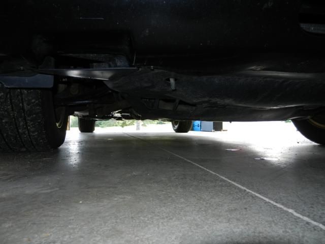

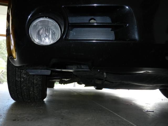

Nice retro fitting of Caddy parts. Did you incase large opening behind wheel well?
Bill, Could you post a few photos? That would be enlightening.
Sam

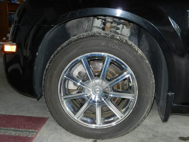

This car sits an inch or two higher due to AWD than a RWD 300C; oddball size stock 225/60 R18 tires allows for larger standard brakes than RWD C come with:
Hard to see horizontal brake cooling duct flush with lower front valance, also a small round cooling hole that I’m not sure just what it is for:

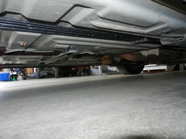

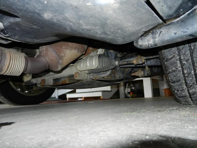

Smooth removable underbelly cowling directing air flow past oil pan, and area between front air dam/bumper to cross member under radiator:
Back edge of belly cowling directing air flow past steering rack under fire wall to flat floor of front foot wells:

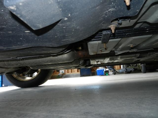

Passenger side to driver’s floor mid car notice how drive shaft, exhaust system is tucked up out of view:
Looking Right to Left side at front of IRS, notice fuel and other lines neatly tucked up in channel:

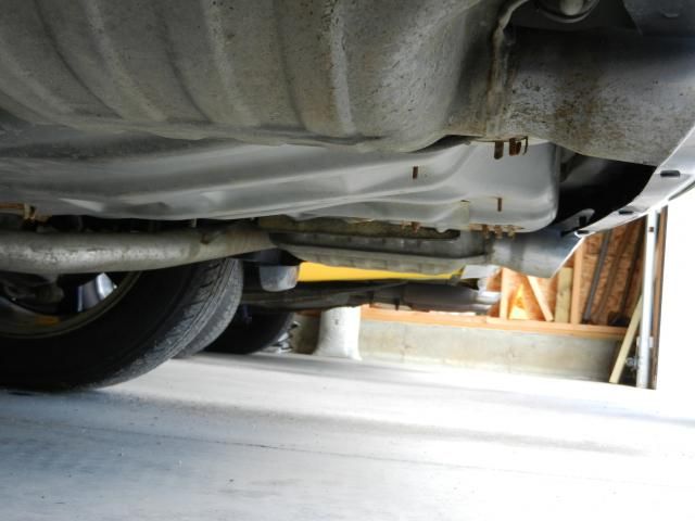

Center rear to front of car, square housing is fixed differential, spare tire well has fin like stampings directing air to base of rear fascia, left is organically shaped rear muffler tucked up into space behind rear wheel and quarter panel:
Drivers side to right side under trunk area showing mufflers, and spare tire well in relation to rear bumper fascia:
