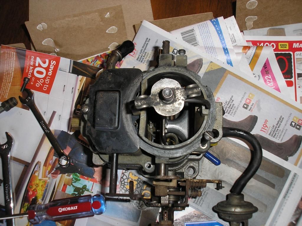

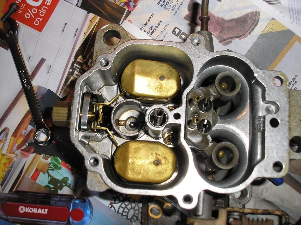

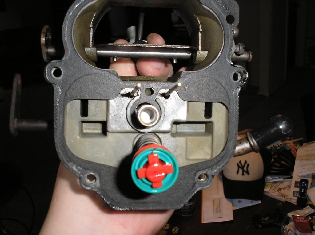

This appears to have been rebuilt recently at the gaskets are supple and it has brass floats and the acc pump looks new...pics to follow

I am not seeing anything immediately apparently wrong in those pictures. Check the inlet needle and seat and check the float adjustment.
Brass floats can also get pinhole leaks. Check that those floats actually float and don't have a hole.
Are you aware that that is a V-8 carb? The PCV valve tube gives it away. Be sure to either use the correct slant six choke linkage or fabricate the adapter to mate the slant six choke thermostat rod to the v-8 carb choke linkage.
Just a quick tip.
Drop the floats in a bowl of hot water and hold them under. If you see bubbles, they have holes. If your careful you can solder them with a soldering iron. Just don't add a ton of solder, and ensure there is no liquid inside them. Some gentle heat from a blow dryer can dry them out. Or splurge and buy new ones to be sure.
