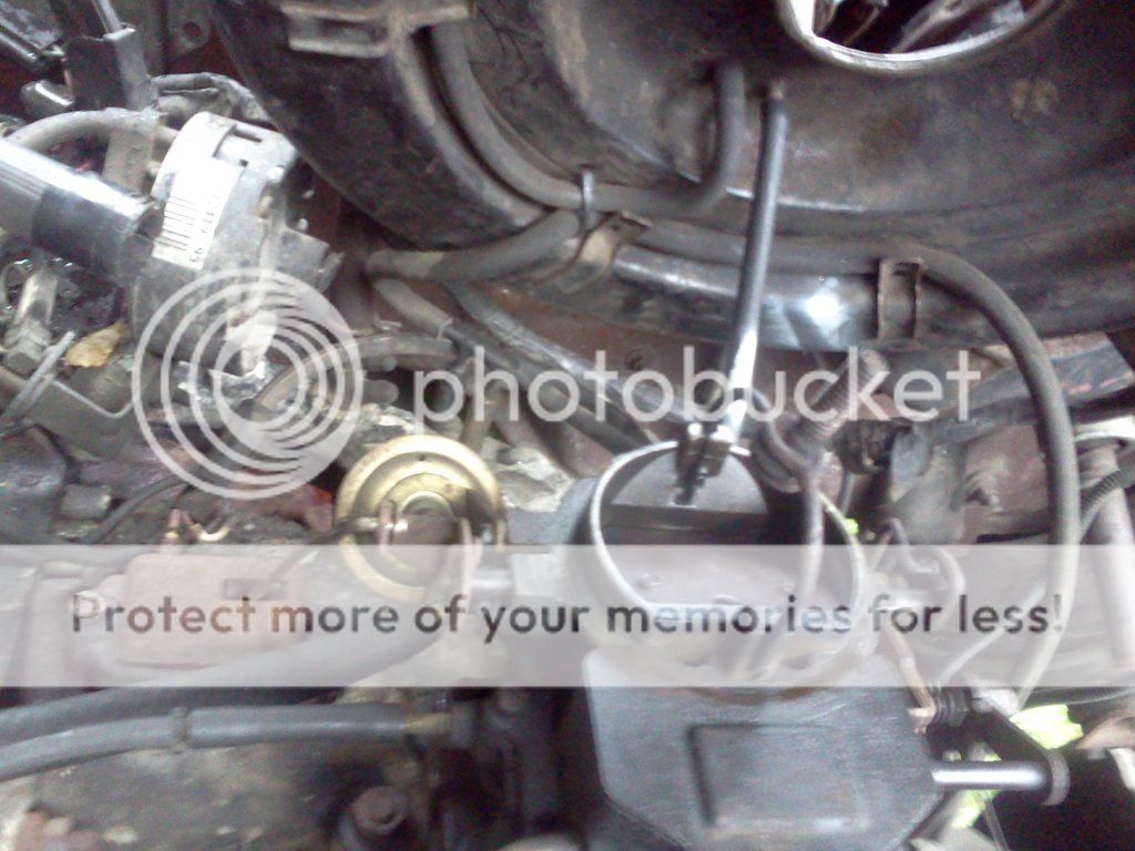

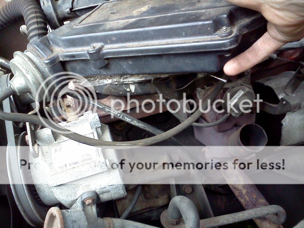

PostPosted: Sat Sep 14, 2013 2:04 pm
Joined: Mon Aug 05, 2013 2:59 pm
Posts: 22
Location: washington
Image[/img]

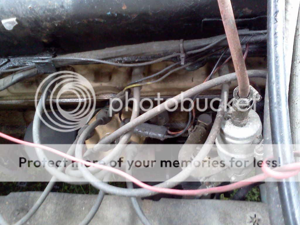

PostPosted: Sat Sep 14, 2013 3:39 pm
Posts: 5613
Location: Downeast Maine
That top image looks to be showing a fuel vapor trap. There should be a stick’ah somewhere under hood with vacuum line routing diagram.
Third Image of distributor is hard to tell, but looks to be missing vacuum advance pod, therefor it is a lean burn device.
There's definitely a lot more vacum lines, and between heat/rubber and sensors seems like a lot more to go wrong, or deal with troubleshooting.
Yup, it’s a bit of a mess, but can be sorted out, and avaluated.
There looks to be some hacking of the lean burn system, and any cracked or disconnected vacuum lines will cause faulty info to be sent to computer, and big drivability problems. To be able to understand and successfully properly sort out this mess one needs to have a factory service manual. I wouldn’t be surprised if all the sensors and related solenoids are in place, but not connected to computer correctly or are leaking or have bad electrical connection.

PostPosted: Sat Sep 14, 2013 8:38 pm
Posts: 13280
Woah, slow down. WJAJR, isn't 100% right on what he says.
THe lean burn system often didn't work right when new and parts are hard to find these days. Usually by now someone has already hacked up the system making repairs expensive and difficult. I have yet to own, encounter, or hear about a vehicle still equipped with a lean burn system that operated properly. Maybe WJAJR had one that worked back in the day when it was new, but nowadays these systems are more trouble than they are worth.
My point is that regardless of how the lean burn system functioned when new, at this late date it is almost guaranteed to be faulty and expensive and difficult to troubleshoot and repair. If you are dead set on keeping the lean burn you MUST get and USE the factory service manual for your exact vehicle. I still recommend you swap out the lean burn system.
The canister you posted a picture of if the charcoal canister which is a very useful thing to have. Yes, you could consider it to be an emissions item since what it does is trap the gasoline that evaporates out of the float bowl when the car is shut off. However, it then stores those vapors and reintroduces them back into the carburetor when the engine next starts. It saves you gas and makes starting the engine easier. It has no adverse effects on performance and really is a beneficial item to have.
Just because a carburetor has a solenoid mounted on the side DOESA NOT mean that you have a computer controlled carburetor. The idle stop solenoid WJAJR is referring to was used for several purposes, none of which were directly related to the lean burn system. Usually the idle stop solenoid was used on AC equipped vehicles to raise the idle a bit when the AC was engaged and the engine was idling. Some years also used the idle stop solenoid to hold the throttle open a bit on deceleration to prevent choking the motor.
If you have an idle stop solenoid, LEAVE IT ALONE AND HOOKED UP! Like the charcoal canister, the idle stop solenoid is a very beneficial item to have and serves a good purpose. Disabling it will just make your car perform worse.
To tell if your carburetor is computer controlled you have to look for wires that go into the float bowl through the upper casting in the carb body. The computer controlled a stepper motor inside the carb that metered fuel going through a jet on the floor of the carb. If you have wires disappearing INTO the carb (not just hooking to a device screwed to the side of the carb) then you have a computer controlled carb. FYI- the stepper motors in the carbs are no longer available new, which is one of the reasons why getting the lean burn system working is expensive and difficult.
You DO have a lean burn ignition system because the distributor has two plugs going to it. Only lean burn distributors had two pickups in the distributor.
The hole in the exhaust right after the manifold is a factory bung that may or may not have been a point of air injection depending on the emissions package of the vehicle when it was built. Some were built with that bung plugged from the factory, others had a pipe from the air pump injecting air there. It looks like your air pump is plumbed into that hole. Leave it be. THe AIR pump draws very little power form the engine and help clean up your exhaust.
On slant sixes the O2 sensor (when one was equipped) went into a hole on the backside of the exhaust manifold immediately above and inboard of the rear protruding portion of the heat riser flapper shaft.
I might be looking at it wrong, but it appears you already have a two barrel carburetor on your motor. The throttle return spring bracket bolted to your intake manifold is clearly the two barrel carburetor piece. Please post some pictures of your carburetor so we can help diagnose your choke and other carb-related issues.
Whatever you do, don't just start blindly cutting hoses and wires. Get a factory service manual and identify every hose and wire you are looking at so you know what you are doing. The lean burn wiring is integrated into a couple other systems so just cutting wires might lead to other problems.

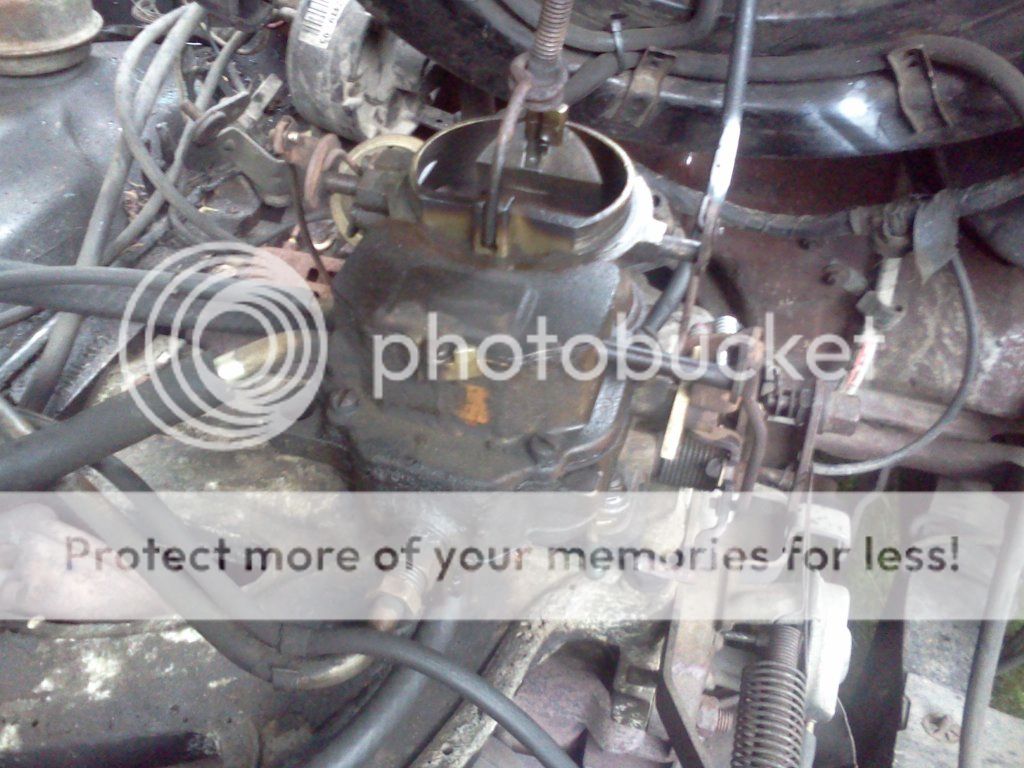

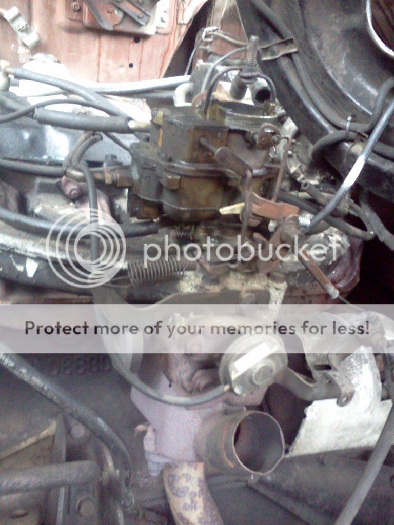

PostPosted: Mon Sep 16, 2013 8:08 am
Posts: 22
 Post subject: carb
PostPosted: Mon Sep 16, 2013 8:12 am
Posts: 22
I didn't see any electrical connections going to carb could be wrong but just tons of vacume lines.. I can cut and plug unneeded ones. Think I'm almost ready to actually do some work.
PostPosted: Mon Sep 16, 2013 8:36 am
Posts: 13280
You do, in fact, have a two barrel carburetor and it actually doesn't have too many lines going to it. I say rebuild the carb you have, check for wear around the throttle shaft, get the throttle shaft rebushed if necessary, and be happy that you appear to have a non-lean burn controlled carb. Are you sure you have a vacuum advance can on the side of the distributor? I can't see one in the pictures you posted and I don't see the vacuum hose that is supposed to go down to the distributor. I DO see two plugs coming out of the distributor body which mens it is a lean burn distributor.
