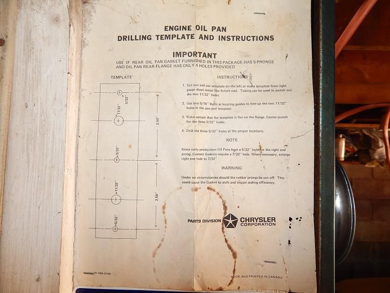

those nubs were changed after 60-61... and I I have some service bulletins at home that I can post about how to modify your pan to fit modern gaskets..
the real gaskets set will give you the same problems unless you do the modification.

The nubs will need pulled through with some needle nose pliers Before Getting the Pan down on the engine. They are a tight Fit.
Here is a picture of the Information I was referring to..
Hopefully that will be somewhat helpful.

Thanks for the reply. Maybe I just got a wonky gasket from FelPro? Also, it is a little odd that I have a 7/32" in one of the spots where the picture you sent says 5/32". We'll see how it goes. I hope to get this figured out.

Ah! I now see the little note on the right hand side:
Some early production oil pans have a 5/32" hole on the right end prong. Current gaskets require a 7/32" hole. Where necessary, enlarge right end hole to 7/32.
That has to be what my issue is. Do you know when that service bulletin is from? I'm just curious since it refers to my issue as an early production oil pan. What defines early production?

not quite sure on that.. I would say 60-61... but I am not totally sure.. I just stapled it to my garage for reference.
Pentastar was not adopted as Chrysler Corporation logo until September 1962, and the typeface used in that sheet was not used that early.
