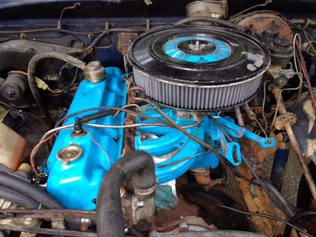

I have a 1982 Dodge Ram, purchased with a /6 supposedly with 142,000 confirmed miles from a nice southern gentleman who swore he would trust that truck to the end of the earth and back. Let's just say I am only now, a year later, fully appreciating the extent to which he lied.
I now have a 1981 /6 purchased from a man equally fervently claiming 73,000 miles on the engine. I have managed to go from only understanding how to change my oil, to taking out the crapped out engine, putting in the hopefully better one (yes, I did this mostly on faith as well as at least understanding that this engine has decent compression). I have put in a new water pump, fuel pump, timing chain, harmonic balancer, distributor, electronic ignition, and added a beautiful refurbished 2 barrel carburetor, intake and exhaust manifolds etc.... plus various little bits and pieces that I lost or messed up in the process.
Here's the puzzle: with the original engine it ran rough, if at all, and did this strange halting, as though it was fuel starved, then stalling with no apparent correlation to speed, load, temp, time etc. With all of this work done (with MASSIVE loads of advice and help with some very kind friends), the truck STILL DOES THIS! I emptied the gas tank and didn't dredge up any sludge or obvious water. I put a new fuel filter on that doesn't have a return to the tank, and I vented my gas cap. It still happens, and now I'm even having trouble starting it.
I have 1,000+ questions, and while I've made vast improvements in my knowledge base I would say I'm still basically at ground zero. If there is a patient soul out there who would be amused to share expert advice I would greatly appreciate it. I also have a lot of pieces to sell or trade for advice as I pieced out the 1981 truck that this engine came from....plus I have the abused 1982 engine and two wonky one barrell carbs if anyone might have a use for those as well.
Many thanks for making it to the bottom of this message. I am on a mission; tired of not understanding my own truck and having had a deep love for the /6 since I got to ride around in my brother's dart as a kid. AND I really NEED this truck to run for my work.....

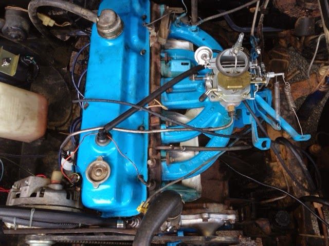

Many thanks for putting your minds to this; but, the lean burn system is gone. It was on the air cleaner of the 1981. The truck with the 82 engine had been stripped of it. So, it didn't have it at all when I first ran the truck with its original engine, nor does it have it now.
Image (alt+p)
I hope the above works to post the images of the engine.... if not maybe just cut and paste the following into your browser?
https://plus.google.com/photos/11378554 ... 4975199921
thanks for your help!

The pictures:
My input:
The cap I am referring to with the arrow pointing at the front of the carb is the fitting below the float bowl between the mixture screws.
What happened to the elctric assist wiring for the choke thermostat (that thing on the exhaust manifold that connect to the carb)?
It looks like you have a cable actuated throttle kickdown linkage but that it is set up to operate backwards. The cable should come at the carb from the front so it is pulled as the throttle is opened and that motion is transfered to the lever on the trans so the trans lever is pulled towards the back of the car as the throttle is opened.
Other thoughts-
Is the carburetor a slant six specific or a 318 Carter BBD? I ask because the chokelinkage is different between the two. If a 318 carb is used on a slant six, the choke will not open fully and will lead to poor performance, much like you describe.
Have your read the Super Six article? Have you verified all the adjustments on the carburetor (choke, metering rods, mixture screws)? Have you verified tha tthe new vibration damper( harmonic balancer) has TDC marked in the correct place? I have purchased new balancers/dampers and found the TDC mark to be 8 degrees off.
What distributor are you running? I see your vacuum advance hose is not hooked up. What springs are in the distributor and is the mechanical timing advance system working properly?
How confident are you that the engine is a 1981 engine? I ask because 1981 was the year of the change from mechanical solid lifter to hydraulic lifters. If the seller was actually selling a 1980 or older engine then you may have a mechanical lifter valvetrain and you may need to adjust the valves.
Other isues may come up and others will have more ideas.

Looking closer, I can't even see the rod between the choke and the choke thermostat. Is it connected?
