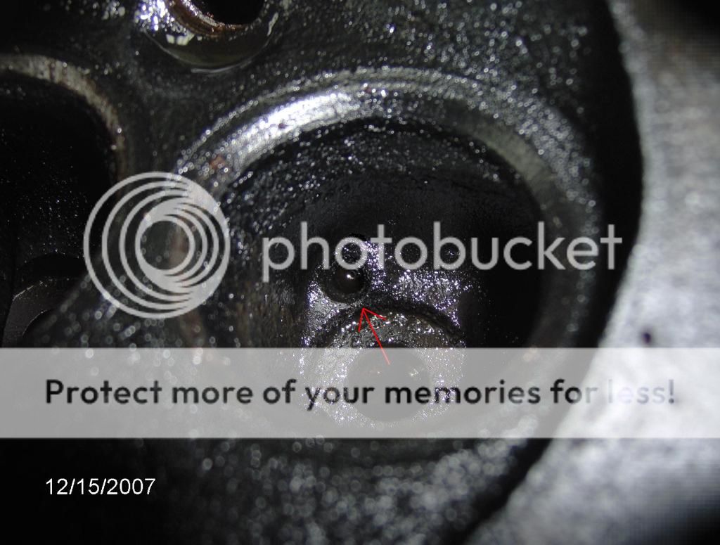

Original poster asked..........'Im in the process of porting a 1980 p/u cylinder head. I was wondering what to do with the small emissions breather holes in each exhaust bowl.
Is there an epoxy that will withstand the temp. or is this mod unecessary?
Doc answered..........You can just grind down the tops of the air injection ports and then plug the main feed hole at the rear of the head. (tap it for a pipe plug or use the air tube flange and flatten / weld the tube closed) ..............
Here is a piss poor picture of that air injection hole on my own head, my camera is not the latest and greatest.
I plan to do as mentioned and grind away the top portion or the area where the casting is raised to eliminate that hump.
I am a little concerned that by doing so I will making the hole that is there larger and more pronounced.
Am I being overcautious?

... Am I being overcautious? ...
Yes.
A 'dead-end" hole in that location has little to no impact on what we need to do on the exhaust side of a SL6 head.
The porting "goals" on the SL6 exhaust side is to have smooth flow out of the chamber, across the valve seat and into the port "pocket".
The flow is pretty good once the "fire" is past the valve head and in the pocket area / exhaust port.
You do want to "round-off" the sharp edges, especially around the valve guide, so you can minimize turbulance as the gases transition from the pocket area and into the port "runner".
As for the exhaust pocket inself... having some open volume, right under the valve seat, simply gives the "fire" a place to go and that little EGR "hole" and the indentation it sits in, helps create additional pocket volume.
