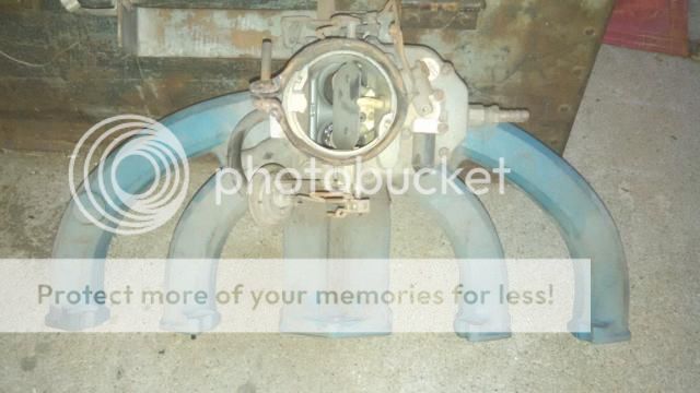

I have seen the two bbl intakes, but the ones I have seen allhave EGR on them...this does not and it's cast iron.

Export or marine?
PostPosted: Fri Aug 15, 2014 9:30 pm
Posts: 24933
Marine. Has provisions for a bolt-on waterbox on the underside; has no provision for vacuum tap on #6 runner.

So would it be a good intake for the street(in a 1/2t truck)?
Thank You.
and YES I removed from a 225 that came out of a boat. Also have the exhaust heat exchanger manifold with big letters CHRYSLER cast into it. Have NO clue what to do with it! :lol:

D'OH! If I had seen the lack of a vacuum tap I would have nailed it.

So I can only assume this will be a good intake for my truck? I plan on a 833 trans and have manual brakes...so I dont think I need the vacuum tap.

Vacuum runs the heater box controls... but you can get a vacuum tap in other ways.

yea man its a good intake.
