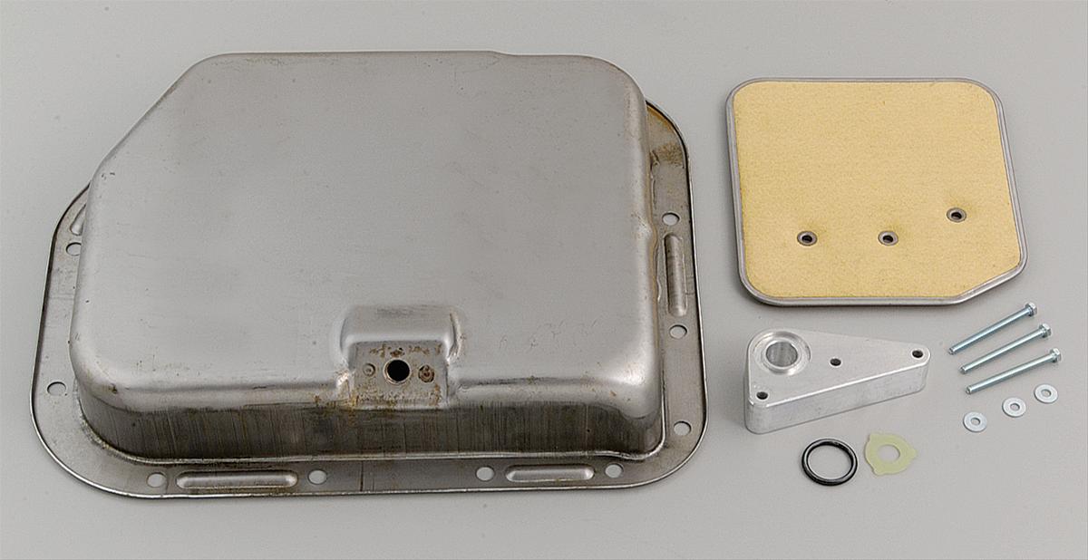

To answer the above question, I haven't torn into this transmission yet. That being said, while idly researching transmission stuff related to my OTHER '64 Dart's troubles, I may have found a hint.
This thread by SlantSixDan describes the process for adding an in-pan transmission filter to pre-1964 cars, which didn't have one. In it, he notes that you need a 1964-65 filter with two fluid ports, one of which feeds the rear pump. 1966+ filters apparently only have one port.
Well... being idiot road racer types, when we installed this transmission after the rebuild, we went and added that Mopar Performance Deep Pan that Dan specifically warns someone not to use in that very same thread. If you look closely at the picture, you'll see that the extension does in fact have only one hole in it. So we apparently starved the rear fluid pump for an entire 14-hour road race. And a test session. And a little bit of freeway driving. :facepalm:
If you look at the diagrams in the '64 FSM, you see that the rear pump is active in all forward gears. It appears to *directly* feed the governor valve. You can probably see where I'm going with this.
Does anyone know if there is an aftermarket filter extension with two ports? Surely someone has put a deep pan on a pre-66 904 before. If not, and if I can't figure out a good way to modify this one, then I guess the original pan is going back on.
What are the chances of my rear pump being utterly smoked? In the worst case, I'm pretty sure I can get the tailshaft housing off without completely dropping the transmission out of the car, so there's that.
