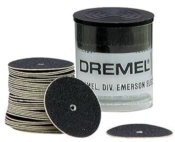

what do i smooth it off with?
PostPosted: Wed Sep 14, 2016 6:11 pm
The little sanding disks on a dremel (they have some give)
Use fine.
