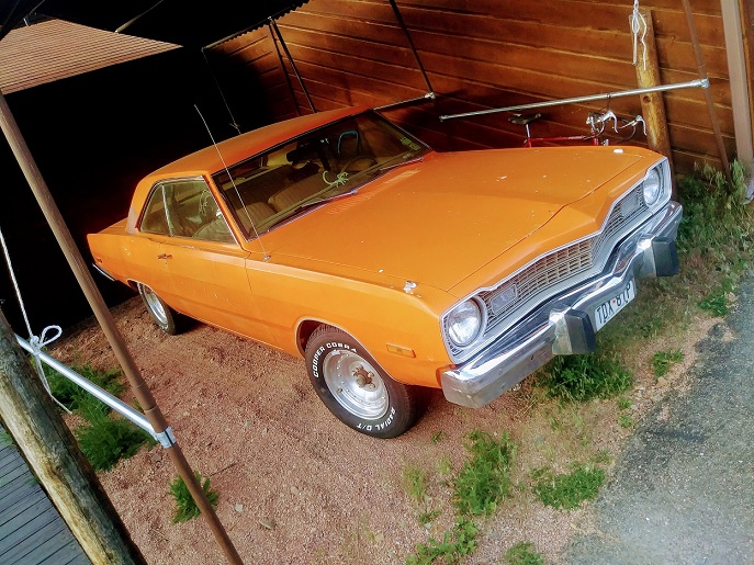

pics of your swinger?

Sure! This is about all I have so far...
