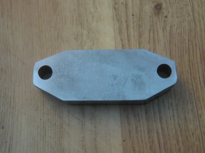

I made an EGR block off plate and a gasket, but they are available online.
Something like this (Someone else's photo):

A blockoff plate as shown above is what I eventually used, but for a couple of months I drove around with the EGR flipped around backwards and left the diaphragm alone. I even kept the vacuum line hooked up. The bottom of the manifold can be left open where it mated to the exhaust manifold. I wouldn't snap off the vacuum diaphragm, just flip the EGR around and go with it until you can get a blockoff plate.
