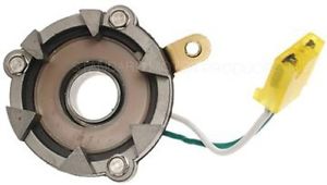

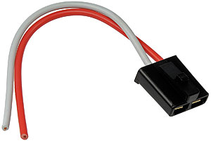

I assume you are using the GM style 4 pin module. You can use two of the Dorman 85841 as it will fit the side with 2 wide terminals perfectly. It will work on the side with the fat and skinny terminal, but it you want something that fits a little better, just get the distributor pickup coil (circa 1976 more or less) and use that. I picked up a Standard LX-309 off ebay for around $5 and just cut the pigtail from that. The Dorman 85841 type connector is widely available just about everywhere. It is the same connector for the (GM) internal regulator alternators.

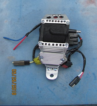

Here is the finished item on my Race Car. I tried to keep it light and compact (and simple).
This is everything, there is even a power relay in there somewhere.
The pigtail that goes to the distributor is a trailer plug, the other two (to the module)are as listed in the above post. I put a piece of red tape on one side of the module power plug to (hopefully) make it harder to plug in backwards. The coil connector came with the coil, but I think it is available separately (Ford application). The only external connections are a blue wire, which goes to the factory ignition power wire (also blue). There is a red wire for power (+12v) applied via the relay. And, lastly, there is a yellow wire for the electric tach (it's yellow only because that was the color it happened to be). I also have a separate ground wire for the entire thing. It isn't really needed, but I feel better with it there.

Thank you everyone for your input! You all are very helpful. And special Thank you to Matt.

But Matt,I do like how yours looks with the Ford coil.
Did you make the custum coil bracket?

Yes, I made up my own mounting bracket. I like things simple, compact, and light (on the race car).
I got a 'heat sink' with the Ford style coil, but I didn't use it. I didn't think the coil needed a heat sink. I just bought some generic heat sink plates on ebay for the module. The one on top of the module is more for looks, but there is one on the bottom as well. I plan to make a second ignition assembly, to have ready at the track as a spare, in case of problems. The harness for this thing is small and wrapped in harness wrap (like tape, but not sticky). For the race car, I am using an Accel coil and module, but my spare will likely have the regular OEM stuff I picked up to build the 'prototype'.
And, as an added (race car) bonus, the HEI setup is about a half pound lighter than the OE Mopar module/coil.
