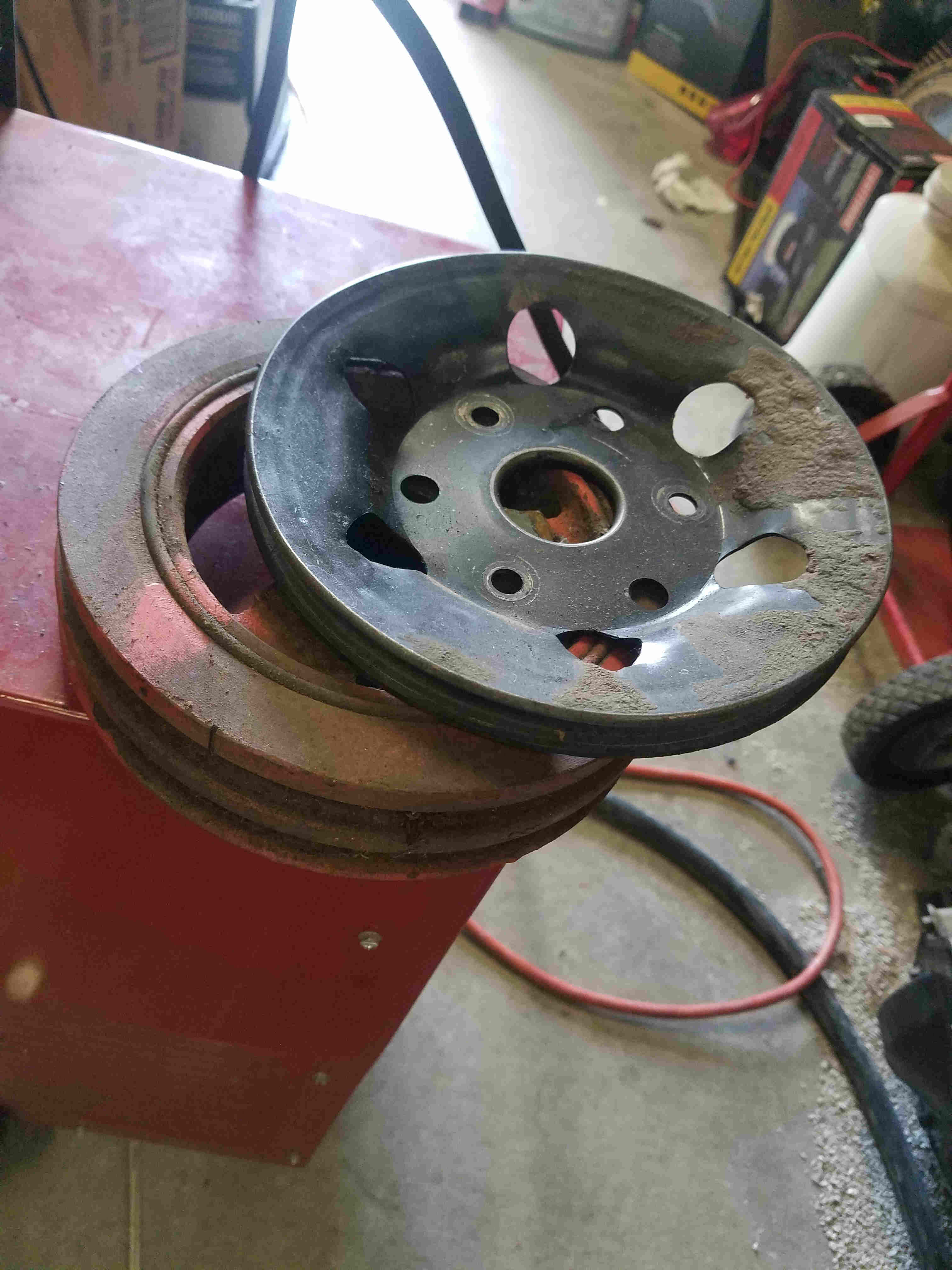

I have a couple of these.
Where are you? One will likely fit one of those priority flat rate envelopes, or the flat rate box.

I can't seem to upload a photo, but the one that Ceej has in his photo is very close, except the center hole on mine is bigger. I believe I need the larger hole so the pulley can fit over the bolt that holds the balancer and the other pulley to the end of the crankshaft. Maybe this was just used for the industrial version?

The one pictured came off an '82 swather. The center hole in the one pictured is 1-3/8", and fits flush to the harmonic balancer when installed. The washer and bolt clamp the assembled pulley and two belt groove balancer to the crank.
Most slants don't have a bolt holding the balancer to the crank. Many industrials did have the bolt. For something that spends it's life coated in dirt, mud and chaff, it's nice to have a bolt in there to keep the threads clean. It's not really there to hold the balancer on, rather to keep the grit out.
I've never heard of a slant throwing a balancer. The outer ring, yes, the whole balancer, no. I bring this up because you can put the bolt on over the pulley face, torque it down, and it will serve it's purpose with no issues.
