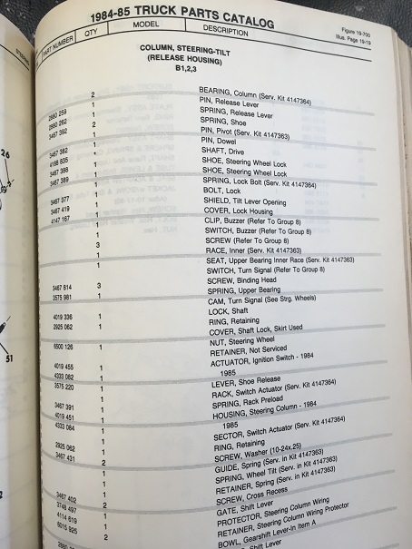

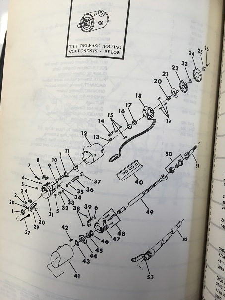

hello, just noticed this post,
the images are from a 84-85 D150 tilt steering wheel parts catalogue
hope this helps,
File comment: tilt steering column items

Thanks, guys! I'm afraid the part is out of production, but if I'm reading it right one from an early Jeep will fit. The tilt wheel bearing is a GM part and is different from the standard column.
