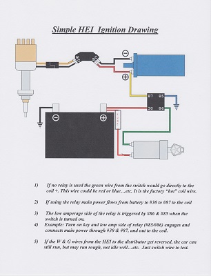

To my knowledge, I was the first guy to actually retrofit HEI to a slant six. I did it working with Goldduster318, a member of the now defunct slantsix.com. I retrofitted the HEI module to a 1974 Valiant that already had an elelctronic ignition distributor. I used no relays and grounded the module to the inner fender support. It worked GREAT. The HEI retrofit is very very easy to do. You are going to be swapping the distributor out anyway, and HEI is not that many more steps.

For a bare-bomes swap you need an electronic ignition distributor, a four pin HEI module, some wire, and some electrical terminals. The ballast resistor us actually eliminated in the HEI swap. There is a very good write up in the electrical faqs on this site of how to do the HEI upgrade.

Many people run relays, but I don't, because it is just one more thing to go wrong and I have never had an issue with any of the 5 or 6 vehicles that I have installed them on. Always have had plenty of voltage over at the HEI module so I didn't worry about it. Not saying they should not be installed. Just that the whole HEI set up can be installed very simply. Only 4 wires on the HEI module. And 2 of them go directly to the distributor. Only 2 more connections! They go to the coil! :D :D You got this!

Posts: 9302
Here is the drawing I use. It is not original with me. Someone made up the nice drawing, I added the notes to help my pea brain remember. Maybe it will help? :D
