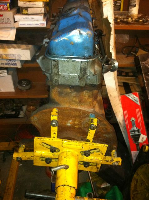

Here is the best way I have found to mount a slant six (and this one is fairly sturdy, even though it is mounted to a three wheel stand and has a head bolted on):

I have a wide 4 wheeled stand, and yes Grade-8 bolts, and I have it mounted very similar to your picture Reed, but I have the top left mount bolted through the top starter hole. I rolled it all around the garage and it’s not going to tip over or anything, it just doesn’t feel solid?(balanced like a V8 )
I do have the head on too.
Must just be me.-Thanks Dan
1964 Dart GT
 Post subject: X2
PostPosted: Sun Jan 29, 2012 4:06 pm
Reed mounts it like I mount mine....2 top bolts to the block the two bottom ones are through bolts.
-D.Idiot

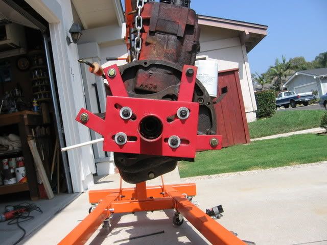

Here's how I did it:
That is how mine is mounted. The Slant scares me! :shock:

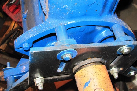

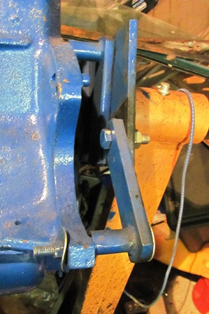

I mount my slants to the stand in a slightly odd way, but it gets the center of gravity lower.
If you look closely, I flopped the top arms around and bolted the top two engine bolts directly to the engine stand head.
I am just using the arm as a spacer. The lower two arms mount in the usual way.
I haven't run into any problems with the engine mounted this way. It just lowers the entire assembly so it doesn't feel quite so top heavy.
