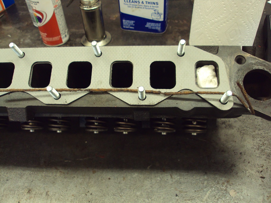

On another note, check out the attached pics. While looking in to the thermostat housing hole I found two lengths of wire in the water jacket. The one I removed ( laying on the head in one pic) came out of the water jacket on the port side of the comb chambers. The other wire is still in the head ( other pic ) and it is on the lifter side of the chambers. Just started to fish it out in that pic. ????????????????? I have no clue as to how they got in there or why.

Author:  ceej [ Sun Oct 07, 2018 8:57 am ]
Post subject:  Re: sick /6 motor
The wires are part of the casting process. Once casting is complete, the sand is removed, but the wire that holds the sand during the pour remain in place.
