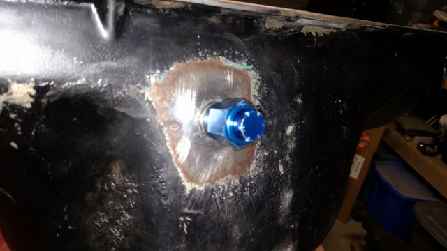

Author:  JohnnyDees [ Mon Nov 12, 2018 3:27 pm ]
Post subject:  Re: placement of oil return fitting
Got to try out my new step drill.

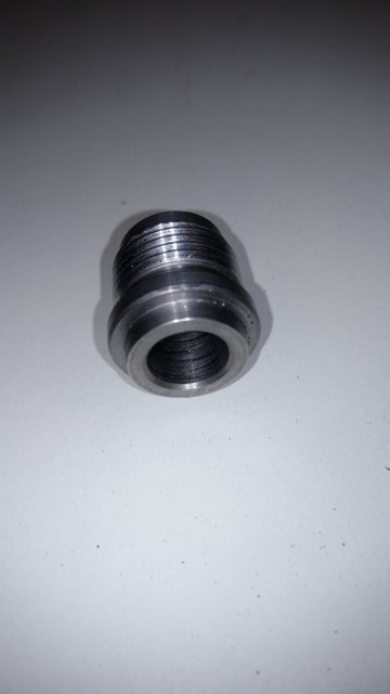

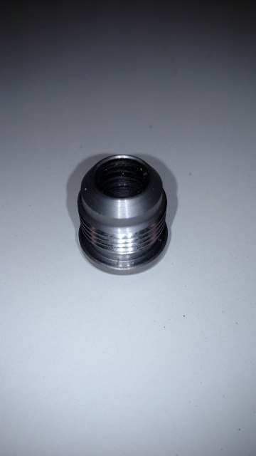

Found a good weld on fitting, the step fit tight in the hole and made welding set up easy.[attachment=0]

Author:  JohnnyDees [ Thu Nov 15, 2018 4:04 pm ]
Yes worked out good. Fit tight I dont even think Ill weld the outside. Maybe some JB weld.

Author:  JohnnyDees [ Thu Nov 15, 2018 4:22 pm ]
It was cheap to, $8.99 for 2 with free shipping. Tried to get it near the main but ended up at the counterweight. .....
Author:  Dart270 [ Fri Nov 16, 2018 2:06 pm ]
Please post the fitting source/link/part number when you get a chance.
The oil just dribbles out so I would not (and did not) worry about location near counterweight or whatever else.
