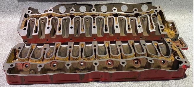

Here is a cut head, very interesting walls.

PostPosted: Mon Dec 20, 2021 6:38 pm
Posts: 10430
Stan, do you have a uncompressed copy of that picture that you could send or email to me?

Concerning the horizontally sectioned head that Hyper Pac posted.
The port wall thickness and the general shape where the head was sectioned looks inconsistent because the saw cut across the head is not level. Look at the material above the spark plug bores. The cut was inconsistent concerning height across the head. The port arm walls are not vertically flat, they have a curvature to them. The bowl (or valve guide area port) walls have a lot of curvature. What is shown on that sectioned head is the effect of cutting through a radius at different heights.
