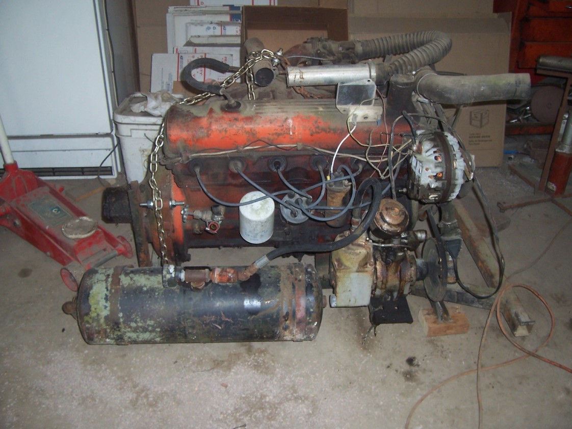

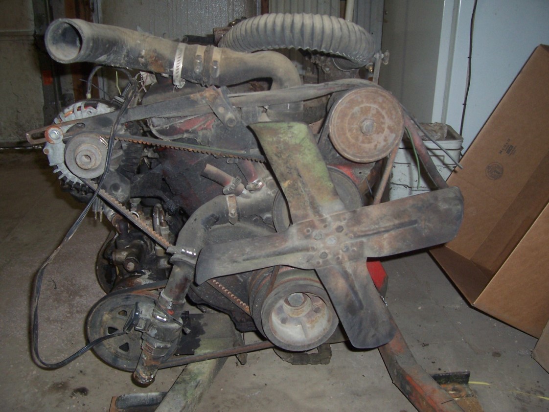

Slant six pictures. Here are a couple of pictures of the /6 these were taken when I first got it in the shop and a picture of my home built log cutting machine. My intentions are to replace the Stihl chainsaw I currently have on the cutter with the slant six mounted ahead of the axle with a drive shaft back to the new Harvester saw that I'm building with chain drive from the drive shaft to the saw. This will give me much more power, heavy .404 pitch chain and a longer bar so I can cut larger diameter or more logs at a time much faster. If you want to see details of how I built the machine you can check my thread on the Outdoor Power Equipment forum at Log cutting machine under Tree Work Equipment by Dave Sr. Thanks for the replies guys I'll probably have more questions after I decide how much of a rebuild I'm going to do on the /6.

Looks like a 64-ish/era engine to me.
NOTE that you can often "cure" low compression simply by doing a valve lash adjustment. Tight valves will do this, and this can happen from valve seat recession or other wear processes. I have saved many an engine by doing this free procedure. Quick and dirty is to simply back off the rocker adjuster screws by 1/2 turn and do the comp test again. You might be happily surprised!
'66-'67 to my eye, judging by the valve cover (min year '66) and the 3 freeze plugs (max year '67).
