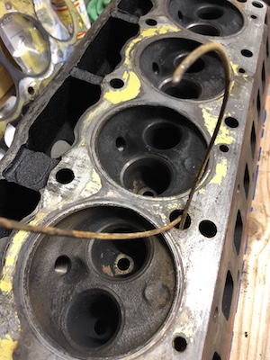

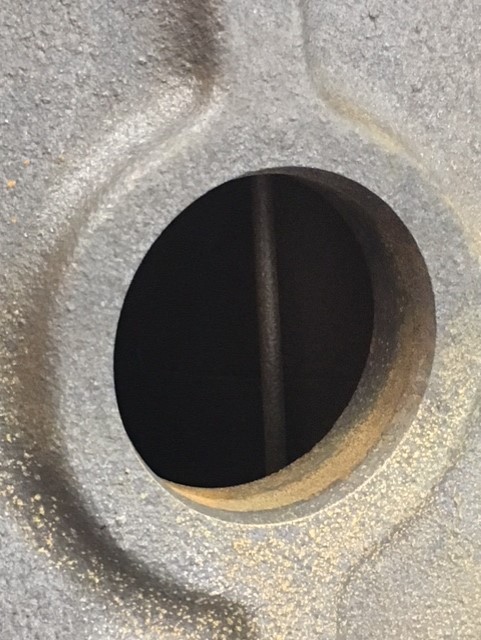

On my 132K mile 1968 vintage 225, the oil pan was caked with dirt and sludge. But the cooling system was in surprisingly 'mint' condition. It looked like whoever owned the car might have had the last name 'Prestone' or something.
Anyway, here is something I haven't seen before...in the water jackets of both the head and block, there are bunch of 'wires'. I'm assuming these were used to hold the casting patterns together (?). I've seen remnants of this in other Mopar engines but never wires that are completely intact. I fished a bunch out of the head...raw steel that never rusted...but left them in the block as they are well-attached.
Anyone else seen this?

I have seen them as well. I usually fish them out as I see no point in leaving them there.

up to the early 70's the most common practice to make engine block and head cores was to use
a method called 'oil sand'. In to a mold that was the shape of the desired core, a mix containing:
sand, oil, wood flour, and some times ground iron oxide was packed or blown. The mold was
flipped over allowing the shaped sand mixture to lay on a flat plate. The sand mix on the flat plate was
then ran through an oven. Out of the oven came a hard core that was the shape of the original mold.
Thin areas of the core were reinforced with wires, specifically cut to shape and bent to fit the core profile.
The wires were placed in the mold and the uncured sand packed or blown around them. In a large foundry there
could be a whole department dedicated to the production of the various shaped wires. The core wires
would have their own part print, specification for diameter, length, profile, dies,,,.
Those are the wires that you are finding. Some large wires, the size of reinforcing rods used in concrete
were re claimed from the spent core and mold sand and were used multiple times. In the subsequent cleaning
and processing of the castings attempts were made to remove the thin wires, but it was known that not all
wires were retrieved.

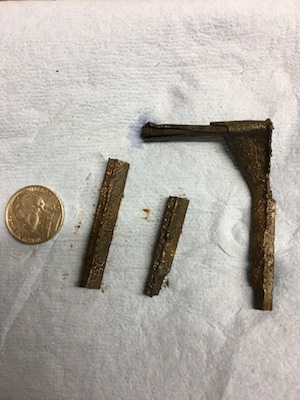

After reading about the core wires on this board I knew exactly what they were when I found some while working with the head on my Sandman engine.

I also shook this corner piece out of there. You can see where there was a thin sheetmetal wrapped to hold the core wire in place.
