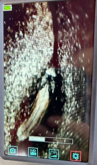

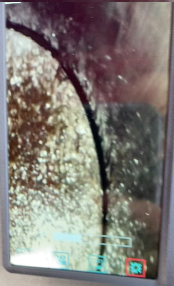

Also, I bought a boroscope camera this weekend and took a peek down the affected cylinders. Couldn't see much due to the angle, but I've attached a couple pics of what I was able to see.

Uh-oh.. that does not look promising..
I am far from the most experienced here on the forum, but it looks to me like your second picture shows the top of the piston missing, and the piston ring is showing...
If that is the case, then I am guessing long term heavy detonation killed your pistons, but that is just a guess.. and it is a wild guess, so it could be wildly wrong..
My second guess is that gas is making its way past both of your dead pistons, and accumulating in the crank case until the vapors ignite and that is what is blowing your oil cap off.. If you smell the oil on the dipstick It will likely smell strongly of gasoline.

Agree, that second photo looks to be a burnt piston.
The only fix is an engine tear down and re build.
Did the slant have any performance work done to it?
Asking as it is very rare for a stock slant to hurt a piston like that.
If you don’t know what may have been done to the engine, be sure to measure piston recession and cc the combustion chambers and take a good look at the cam to see if it is stock or not. Also check the piston ring end gaps.
