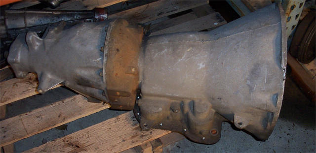

Weird. I'd like to see a pic. I don't see how the starter would line up, with or without an adapter.
 Post subject: Re: Slant w/ 727
PostPosted: Sat Apr 20, 2019 9:22 pm
Posts: 13367
The torque converter stays in the same spot in the trans, the starter motor bolts to the trans, so there is no misalignment between the starter and the ring gear. The flex plate is spaced backwards to the trans from the crank by a spacer that is the same thickness as the adapter. The last two pictures are the flex plate spacer.

So here's my 'rare and exotic' Torqueflite photo. Anyone know what it is? I can tell you it is an OEM 'factory' arrangement...
