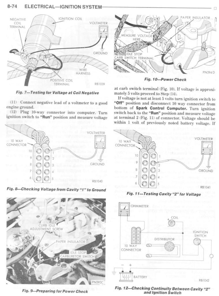

Your truck originally had a "lean burn" ignition system. You still have the remnants of it. You need to see what is left of the system. Stock, the lean burn distributor did not have a vacuum advance pod. All of the advance was provided by the computer. I recommend spending some time seeing what you still have on the truck before you make a decision about replacing the ignition system. I am attaching the factory service manual pages detailing how to work on a lean burn system. You will need to make sure all of the original sensors are present and hooked up, and especially that the ignition computer has a source of manifold vacuum hooked to the vacuum transducer on the computer. The computer is located behind or possibly under the battery. The lack of timing advance sounds like the vacuum hase has been disconnected form the computer or the vacuum transducer is bad.
If you decide to replace the ignition system, I would not use an eBay kit. First, new ignition modules are junk for China and very often don't work even new. Second, the distributor timing advance curve will not be even close to what you want in a truck.
For less than $230 you can order everything you need for the HEI conversion from Rockauto. It is actually easier to install HEI on a lean burn vehicle than to switch to Mopar electornic ignition. THe HEI swap requires no wiring modification and only requires attaching two wires to the coil.
ImageImageImageImageImage[img]https://hosting..photobucket.com/albums/v484/slantsixgoon/Lean%20Burn/Lean%20Burn%20Troubleshoot/CJLEANBURN_Page_07.jpg[/img]ImageImageImageImageImageImageImageImageImageImageImageImage
