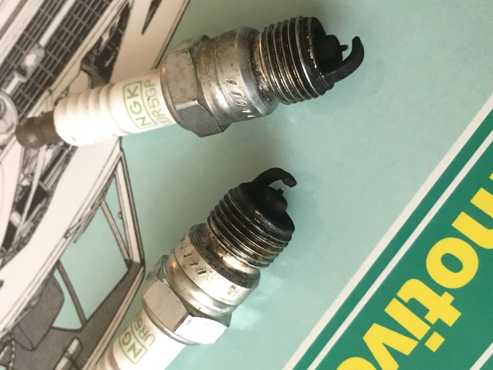

My car, an original-engine 1971 225-cube Six with the Holley 1920, is fouling up its spark plugs and, as a result, misfiring and running really rough on idle.
A similar rough idle issue was, a few weeks ago, linked to a massive vacuum leak: my valve cover bolts had backed off, and oil got in a bunch of places it shouldn't, clogging the air filter and wreaking havoc. I figured that out during a tune-up in which I also replaced the plugs with new NGK platinum-tip UR5s; and the choke thermostat, which I had been told a few years back by a carb expert was in need of replacement. (It looks like the linkage rod was shortened and re-welded together.)
After the tune-up, the car ran great for about a half-hour, absolutely perfectly; the engine was already warm from being on and off during our troubleshooting, so not sure what the choke thermostat was up to at that point. Two days later, I gave it a start from cold and let it idle: smooth for the first minute, and then gradually rougher for the next minute. After a twenty-minute drive, it was missing badly at idle, and almost stalling at stoplights. Pulling a plug (pictured) shows dry fouling, I'm assuming from running rich.
I have a few theories I want to mull over before giving it and taking it to a shop:
1) Is it possible the plugs themselves could be the issue, and replacing them with a more-correct set would solve the whole thing? I got my hands on some NGK ZFR5Ns, removed the crush washers and gapped them to between 0.035 and 0.040, but don't want to try this guess out just to foul them up, too.
2) Could the new choke thermostat be feeding it too much fuel at idle? If so, is it better to switch back to the old, original one or to tune the carb with this new one in place?
3) The car just came out of storage so the gas is stale, and, as noted above, there's probably still oil in a bunch of wrong places. Is it possible these things could contribute to the plug fouling? Is it maybe wet-fouling and not a mixture issue at all, and I still have a leak somewhere?
Sorry for clogging up the forum with an age-old question. With the really rough idle, I don't want to take it farther than the Crappy Tire (er, Canadian Tire) up the street, but I really hate going to a shop where they do who-knows-what to it.
Thanks for any help! Much appreciated!

Have you adjusted the valve lash? If not, time to do that. That can cause these symptoms, as can other things, but it is best to do the valve adjustment and make sure that is not the problem before you work on other things.

Just my experience, platinum ugs are not the best choice, especially for cars that get started and shut off frequently. They need to be started, warmed up, and run a good amount of time before being shut off or they foul.
Hyster used GM V-6s that had platinum plugs in them. We would get trucks in that had already fouled some just loading and unloading them, and that was with fuel injected engines. The factory fix was to have us pull them and install regular plugs.
I'm guess that with a choke you're not running it long enough at a time.

Those are the wrong spark plugs for a 1971 engine with spark plug tubes. Taper seat plugs are for later engines without spark plug tubes. You'll need to install the new plugs regardless.
As a slant requires more frequent maintenance than newer engines I suggest standard spark plugs so you get a more frequent view into the combustion chamber.
If the valve cover leaked enough oil into the spark plug tubes to soak the spark plug boots you'll need to change the spark plug wires.
I second the call for a valve lash check. .010" on the intake valves and .020" on the exhaust. If this gets reversed the engine will idle well cold and then get rough when warm.
Take the air cleaner off with the engine cold. Operate the throttle linkage to see that the choke closes. Start the engine and observe the position of the choke plate. The choke pull-off should immediately open the choke a set amount. If it doesn't check the choke pull-off operation with a vacuum pump. Warm up the engine and again observe the choke position. If it isn't fully open then you need to troubleshoot and/or adjust the choke thermostat. Also look down the carburetor with a light and make sure no fuel is dripping from the main venturi at idle. If fuel is dripping then there is a problem with the float system.

Great catch on the plugs, Josh. Plugs that are 3/8" too short will probably foul pretty fast! Still should do/check the valve lash...
