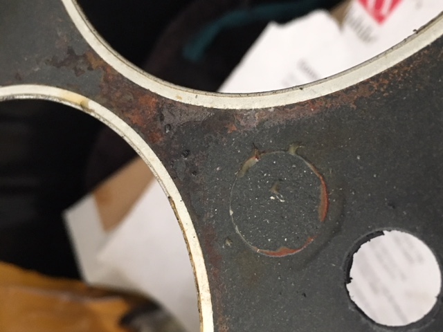

In another vein, I used the Sealed Power head gasket, which is a modern Teflon type gasket that happens to be the identical part as offered by Fel Pro. I'm not overly impressed with the gasket. It clearly states 'do not use sealer' on it. In the lifter rail areas, I did use some silicone to prevent the usual rail leaking - and it was working flawlessly, dry as a bone. But on one of the water jackets, I could see that some water had oozed out and made its way between two cylinders and even gotten a little rusty. I doubt this would have caused any issues, but it's still not what you like to see.
