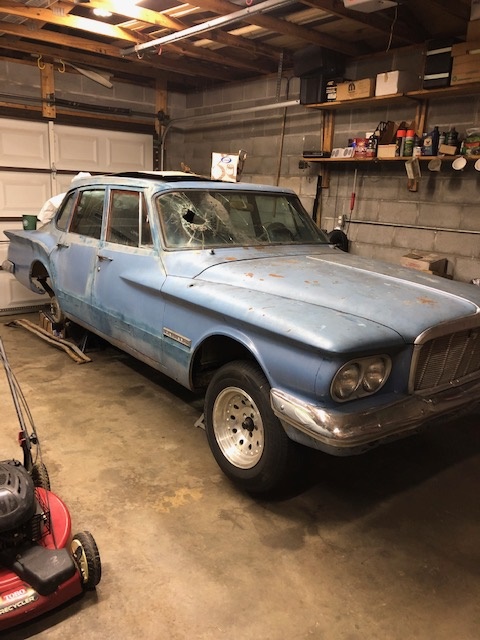

I have the set of American Racing wheels and tires I got for Toadracer when I thought we would stick with the small bolt pattern. We have now upgraded to large bolt pattern.
The previous owner smoothed the back of the wheels to better fit drum brakes. I gave $225 for them about a year ago. I don't think the tires have ever rolled outside of the garage.
I can send you pics if you're interested.
