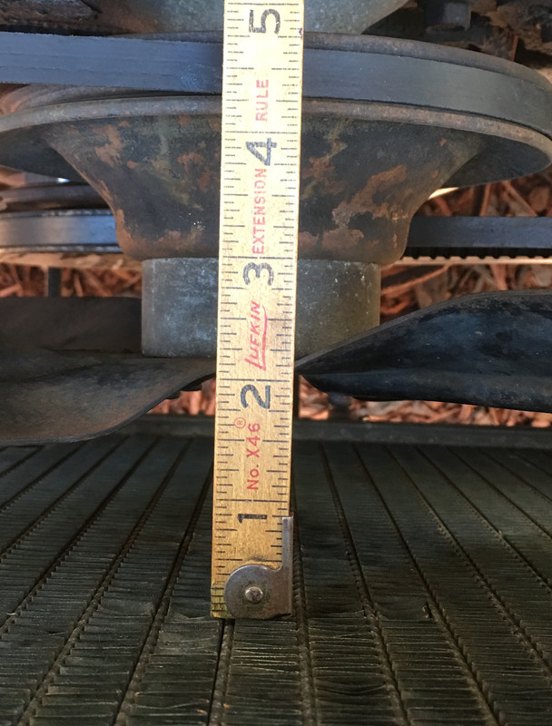

PostPosted: Fri Jun 14, 2019 5:31 pm
Posts: 13421
So, three total inches between the back of the rad and the pulley face? Let me go measure something.
