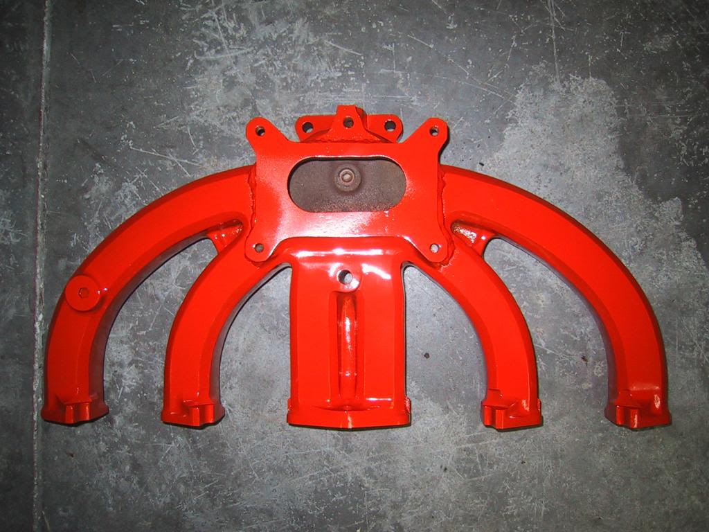

I would use an electronic ignition distributor and a GM HEI module for ignition. Pertonix has proven less reliable than HEI when a good HEI module is used.
The stock exhaust manifold really isn't a bad piece when in good condition. Use 2 1/4" exhaust from the manifold into a high flow muffler. Muffler choice and tail pipe diameter depends on the sound desired.
The Super Six 2bbl carb and intake is what I'd use on an otherwise stock engine. If you can't find that and are handy with a welder you can modify the original intake to accept a Holley 2300 type or Motorcraft 2bbl.
